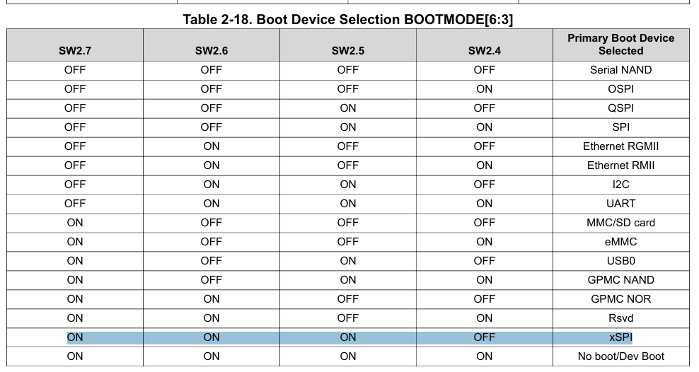

I have copied tiboot3 (mtd0) , tispl (tispl), u-boot(mtd2) to NOR flash using flashcp command.
And changed boot mode switch to xSPI.
Log while booting for NOR Flash :
U-Boot SPL 2024.04-ti-ga8b0d736645e (Jul 09 2026 - 06:16:46 +0000)
SYSFW ABI: 4.0 (firmware rev 0x000b '11.2.5--v11.02.05 (Fancy Rat)')
SPL initial stack usage: 13568 bytes
SPL: failed to boot from all boot devices
### ERROR ### Please RESET the board ###
Please guide me how to resovle this error?

  • Hi Tejas,
    The log is from the tiboot3.bin (R5 SPL) loaded from NOR flash.
    R5 SPL is trying to load the next stage image (tispl.bin) and cannot find a valid image on any device in its configured boot list, which, since you're in pure OSPI boot mode (no SD card fallback), effectively means the OSPI read of tispl.bin failed or didn't validate.
    Can you share the partition layout from U-boot DTS?
    Also, please share the defconfigs being used, the steps/guide that you've used to build the OSPI bootloaders, and the SDK version.

  • Hi Vinu,
    As Per TI AM62Ax SOC TRM.  Can you please confirm which boot mode are supported for OSPI and xSPI boot by Boot ROM code?
    Tejas Patel
  • Hi Vinu,
    with SFDP disabled, and selecting 1S-1S-1S mode that time below error is coming.
    with SFDP disabled, and selecting 8D-8D-8D mode that time nothing is coming on screen.
    Looks like 1S-1S-1S mode is matching between NOR Flash and TI AM62Ax SOC.
    Tejas Patel
