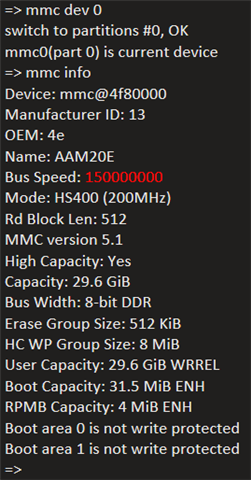

  • Hi Gokul,
    Thanks for your support. I tried your suggestion but it still show 200MHz as shown below
    However, I did see some changes in U-Boot as highlighted below. It was 200000000 before I rebuilt the image with your suggestion.
    Here's related device trees configurations.

    Please advise the next step.

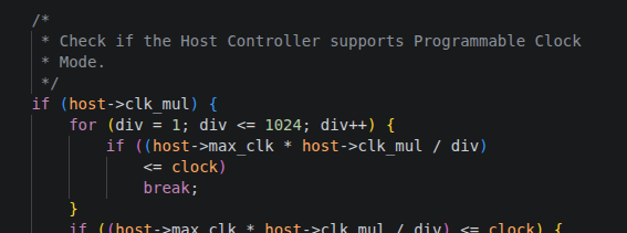

  • HI Charles,
    Thank you for your prompt response.
    I now digged depper and found out that 150Mhz cannot be achieved because the way output clock frequency is achieved is using the following formula:
    • div >= input clock(200Mhz)/clock(150Mhz)
      • Here, div>=1(ie:200/150)
    • actual_clock = Input clock(which is 200Mhz) / div.
    As there is no input clock with 150Mhz, the only possible actual clock values are 200Mhz(200/1), 100Mhz(200/2) and so on....

  • Hi Charles,
    Can we change input clock to something other than 200MHz? for example, select a different input clock source, or configure PLL to change input clock frequency away from 200MHz? If yes, how?
    No, this is not possible actually.
    2. Can div=3? If yes, how to change div in software?
    No, div=3 is not possible. The only possible divisors are 1 and multiples of 2.
    Div cannot be changed in software.It is calculated using the below logic. In your case for clock =150Hz which you have given the div value is  div=2 as ((200Mhz)/2<=150MHz).
    Can we modify eMMC driver code to hard-code 150MHz? If yes, how?
    No , that is not possible, as the hardware will not support it.(the only possible actual clock values are 200Mhz(200/1), 100Mhz(200/2) , (200/4), 200/6 ...)
