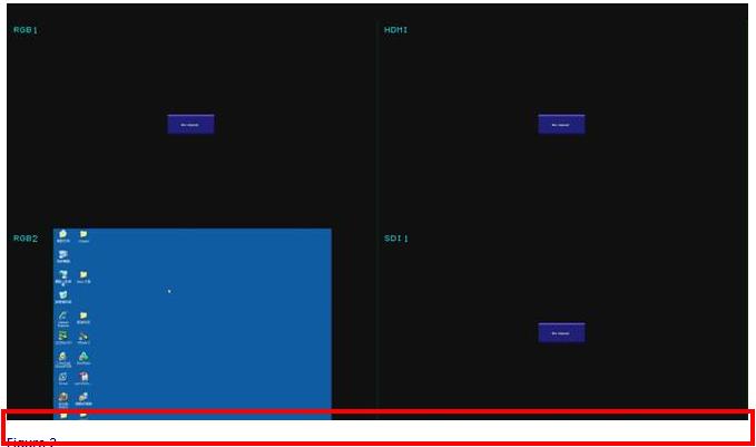

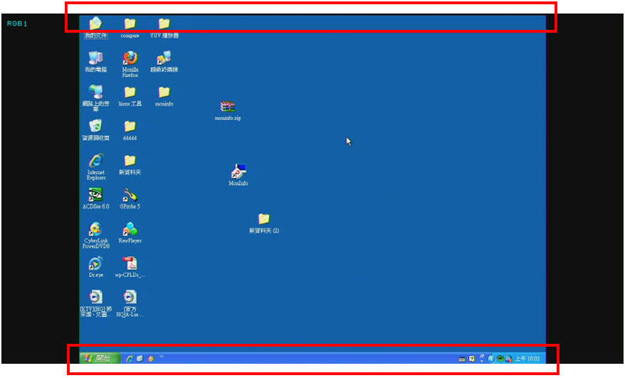

I use DVSDK_4.01 4_01_00_09 as my code base on DM365 to implement our application. But I encounter the video shift issue as below.
Figure 1. The top side gets a more space like a black bar.
Figure 2. The bottom side has a portion disappears
Can anyone give me some hints about this issue? Thanks in advance.

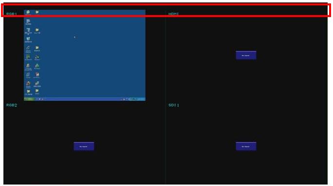

    I modify the psp/linux-2.6.32.17-psp03.01.01.39/drivers/char/dm365_ipipe_hw.c as below setting.
    459 : original -> regw_ip(config->ipipe_vps & IPIPE_RSZ_VPS_MASK, IPIPE_SRC_VPS);
             new      -> regw_ip(0x13 & IPIPE_RSZ_VPS_MASK, IPIPE_SRC_VPS);
    After modity ipipe_vps register to 0x13, the video shift issue is improved as below figure.
    But the top side still has a little black space.
    PS:If I modify ipipe_vps register smaller than 0x13, the video will crash.
    Can anyone give me some tip?
    Thanks!!
    figure:setting ipipe_vps register to 0x13
