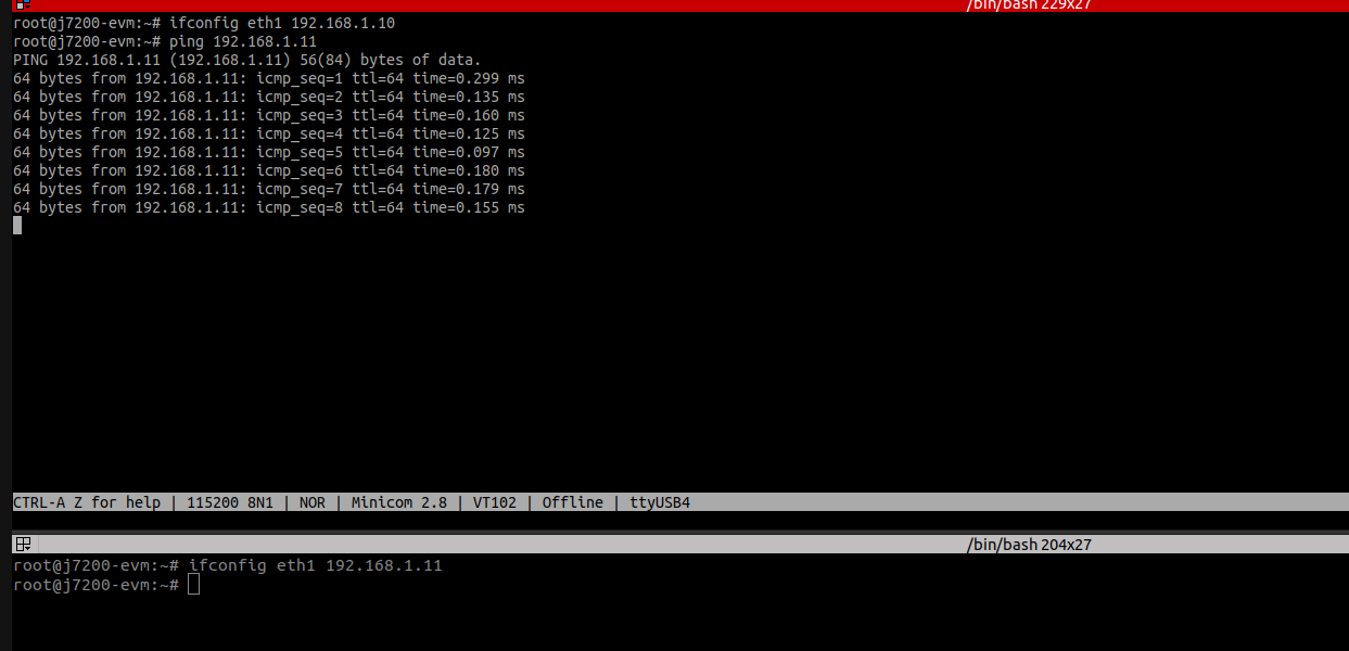

    Note: 10G is supported only from MAC Port-1 on Silicon Revision 2 SoC.
    NOTE: This was tested on  J7200 EVM 11.02 LINUX SDK:
    • Ensure that you have 2 J7200  boards.
      • Connect the ENET EXPANSION CONNECTOR of both the boards using a MAC to MAC bridge.
    • Ensure that you apply the below patches to both the boards:
      • UBOOT :
        • Disable SERDES being configured from UBOOT so that Linux can configure it.

    • Once the above changes are done, follow the below steps:
      • Rebuild uboot , linux , k3-j7200-common-proc-board.dtb, k3-j7200-evm-usxgmii-exp1.dtbo.
      • Copy these files to their appropriate locations in boot media.
      • Go to the <boot media root partition>/lib/firmware directory and enter the below commands
        • sudo ln -s -f ti-ipc/j7200/ipc_echo_test_mcu2_0_release_strip.xer5f j7200-main-r5f0_0-fw
          sync
        • This ensures that ethfw also does not configure SERDES , so that Linux can configure it.
    Output logs:
