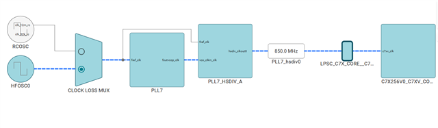

    Open the Clock Tree tool within SysConfig to visually trace a component to its clock source and read the operational frequency.
    • Software Product: AM6X Clock Tree (1.1.4)
    • Device: AM62A3-Q1
    DCC0 4-267
    DCC1 4-268
    DCC2 4-269
    DCC3 4-270
    DCC4 4-271
    DCC5 4-272
    DCC6 4-273
    MCU_DCC0 4-274
    MCU_DCC1 4-275
    Source Clock Frequency:
    • Device: AM62A3-Q1
    Start the design →  Search the component of interest
    Example: C7X256V0_C7XV_CORE_0
    The clock source for C7X256V0_C7XV_CORE_0 is PLL7_hsdiv0 and the frequency reaching C7X256V0_C7XV_CORE_0 is 850 MHz.
    → To find the DCC mapping of the above source clock source i.e PLL7_hsdiv0 refer to the The DCC Input Clock Source Mapping table in AM62Ax Sitara Processors Technical Reference Manual.
    The C7X256V0_CLK (or PLL7_hsdiv0 ) clock source is mapped to DCC3 instance → DCC_CLKSRC2_CLK.
