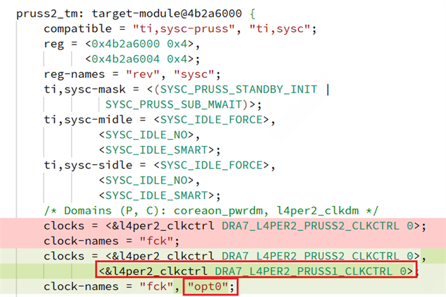

Hi, Experts
The SDK version we are using is 09_02_00_311, and the kernel version is 6.1.119. We have configured PRU2's prueth to be used as two independent network interface in Linux.
During boot, an oops occurred, and after the system starts, the network cannot be pinged. Below is the oops information. What could be the possible cause?
