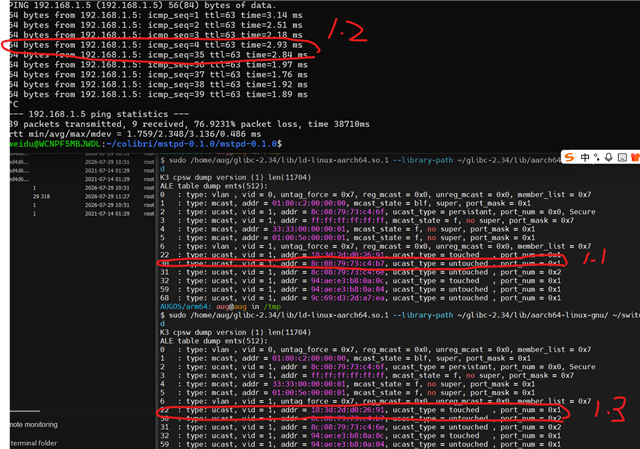

Problem Description:RSTP convergence test does not meet the time requirement, with occasional convergence times exceeding 20s.
Test Description:The DUT is connected to switches to form a ring network, with RSTP enabled (using the userspace program mstpd 0.1.0). A PC uses ICMP to test RSTP convergence time.
Test Topology:PC - Switch 1 --(eth0) DUT1(eth1) -- (eth0)DUT2(eth1) -- (eth0)DUT3 (eth1)-- Switch 2 -- Switch 1
Test Steps and Observed Issues:
The DUT device is AM6422, with eth0 and eth1 configured in CPSW Switch mode.
When Switch 2 is powered on, DUT2 eth1 negotiates to the Alternate port state.
When Switch 2 is powered off, DUT2 eth1 negotiates to the Designated port state.
During the transition from Switch 2 power-on to power-off, the PC-to-DUT3 ping convergence time occasionally exceeds 20s.
Problem Investigation:
After Switch 2 is powered off, port mirroring enabled on  Switch 1 captures a large number of ICMP request packets from the PC pinging DUT3. However, when DUT1 captures packets on eth0 using tcpdump, these ICMP requests are not observed.
Question:Is it possible that the ALE FDB is not flushed, causing ICMP requests to be dropped before the FDB entries age out?

    Can you provide the specific commands/script you are using to setup RSTP?
    What specific steps/script did you use to configure the DUT devices into CPSW switch mode?
    The mstpd 0.1.0 logs show that when an RSTP topology change occurs, it calls/sys/class/net/eth0/brport/flush to clear the bridge FDB.
    Can you share the contents of the mstpd logs?
    Is it possible for you to do a sanity check on this perhaps by manually forcing an fdb flush?
    # On each DUT, after Switch 2 power-off:
    bridge fdb flush dev eth0 # Or your bridge interface (e.g., br0)
    # Monitor if ping convergence improves immediately
    -Daolin

    4. bridge fdb flush command not support on my system,  I just try to remove added_by_user check. It seems work, no exceeding 20s.
    In order to verify if this is an issue with the driver and your workaround is the solution to the problem, I would need some time to reproduce the problem. To do this 1. can this issue be reproducible on TMDS64EVM? 2. is there a simpler topology than the one described that can reproduce the problem?
    -Daolin

    Current TMDS64EVM is not available.
    Please refer the following simple topology to reproduce this problem:
    Ring Network link
    SW - DUT1 - DUT 2 -- DUT3 - SW
    RSTP topology
    SW:  root bridge
    DUT 2(Alternate Port) -- DUT3:   DUT2 eth1 port is Alternate Port connect to DUT3
    Test step
    1. ping DUT1 on DUT3,   DUT1  eth 0 study DUT3 MAC, please refer picture 1.1
    2. PC continuous ping DUT3 , please refer picture 1.2 about the first 4 ping request
    3. Unplug cable between DUT3 and SW,  ping timeout about 30 times, refer 1.2
    4. the DUT1  eth 1 study DUT3 MAC and ping restore, please refer picture 1.3

    DUT1 ALE dump log and eth0 packets drop in ale dump and drop log.txt
    $ sudo /home/aug/glibc-2.34/lib/ld-linux-aarch64.so.1 --library-path ~/glibc-2.34/lib/aarch64-linux-gnu/ ~/switch-config -             d
    K3 cpsw dump version (1) len(11704)
    ALE table dump ents(512):
    0   : type: vlan , vid = 0, untag_force = 0x7, reg_mcast = 0x0, unreg_mcast = 0x0, member_list = 0x7
    1   : type: mcast, addr = 01:80:c2:00:00:00, mcast_state = blf, super, port_mask = 0x1
    2   : type: ucast, vid = 1, addr = 8c:08:79:73:c4:6f, ucast_type = persistant, port_num = 0x0, Secure
    3   : type: mcast, vid = 1, addr = ff:ff:ff:ff:ff:ff, mcast_state = f, no super, port_mask = 0x7
    4   : type: mcast, addr = 33:33:00:00:00:01, mcast_state = f, no super, port_mask = 0x1
    5   : type: mcast, addr = 01:00:5e:00:00:01, mcast_state = f, no super, port_mask = 0x1
    6   : type: vlan , vid = 1, untag_force = 0x7, reg_mcast = 0x0, unreg_mcast = 0x0, member_list = 0x7
    23  : type: ucast, vid = 1, addr = 94:ae:e3:b8:0a:04, ucast_type = untouched , port_num = 0x1
    24  : type: ucast, vid = 1, addr = 18:3d:2d:d0:26:91, ucast_type = touched   , port_num = 0x1
    32  : type: ucast, vid = 1, addr = 94:ae:e3:b8:0a:0c, ucast_type = touched   , port_num = 0x1
    68  : type: ucast, vid = 1, addr = 9c:69:d3:2d:a7:ea, ucast_type = untouched , port_num = 0x1
    132 : type: ucast, vid = 1, addr = 8c:08:79:73:c4:b7, ucast_type = touched   , port_num = 0x1
    45  : type: ucast, vid = 1, addr = 94:ae:e3:b8:0a:04, ucast_type = touched   , port_num = 0x1
    69  : type: ucast, vid = 1, addr = 8c:08:79:73:c4:6e, ucast_type = untouched , port_num = 0x2
    132 : type: ucast, vid = 1, addr = 8c:08:79:73:c4:b7, ucast_type = untouched , port_num = 0x1
    AUGOS/arm64: aug@aug in /tmp
    68  : type: ucast, vid = 1, addr = 9c:69:d3:2d:a7:ea, ucast_type = touched   , port_num = 0x1
    132 : type: ucast, vid = 1, addr = 8c:08:79:73:c4:b7, ucast_type = touched   , port_num = 0x2

    You can try the following steps to reproduce this issue without a switch.
    Ring Network and RSTP topology
    DUT3(root bridge)-DUT4-DUT5-DUT1-DUT2-DUT3
    Test step
    1. Log into the terminals of DUT2 and DUT3 respectively, and continuous ping DUT1
    2. stop ping DUT1 on DUT3
    3. Unplug cable between DUT1 and DUT2
    You can observe that ping DUT1 on DUT2 will  be timeout about 30 seconds.
    This issue may be caused by the CPSW's FDB not being flushed.
    • Test Step 1: Dump the ALE on DUT3, and you can see that DUT3's eth0 has learned DUT1's MAC address.
    • Test Step 2: It can be observed that the DUT1 MAC address learned by DUT3 does not age out.
    • Test Step 3: Due to a change in the RSTP topology, the ping request from DUT2 to DUT1 will be sent to DUT3's eth1 interface. At this point, the MAC address of DUT1 learned on eth0 has not yet aged out, so on DUT3 the CPSW will drop the request.
    Once the MAC address of DUT1 learned on eth0 ages out, the ping request from DUT2 to DUT1 will be flooded. Dumping the ALE will show that DUT3's eth1 has learned DUT1's MAC address, and the ping from DUT2 to DUT1 will return to normal.
    And when RSTP topology changes, mstpd will flush mac by write /sys/class/net/eth0/brport/flush. But this flush action is not
    effective at cpsw driver dut to some check rule, like added_by_user and vid.

  • Hello Daolin,
      Same issue on SDK 12.01.00.05.03
     1) ALE dump on DUT3, 8c:08:79:73:c4:6f is DUT1:
    2) ping DUT1 on DUT2

  • Hello Daolin,
      Following test steps can reproduce this issue with rstp disable.
      Network topology, 5 DUTS connect, not a ring
     DUT5-DU4-DUT1-DUT2-DUT3
    Test step
    1. Log into the terminals of DUT1 and DUT2 respectively, and continuous ping DUT3
    2. stop ping DUT3 on DUT1
    3. Unplug cable between DUT2 and DUT3
    4. plug cable between DUT3 and DUT5 immediately
    5. Flush DUT1 eth0 fdb by mannaul with sudo sh -c 'echo 1 > /sys/class/net/eth0/brport/flush'  This command simulates RSTP TC  events.
     You can observe that ping DUT3 on DUT2 will  be timeout about 30 seconds.
    These my test log
    DUT1 log;
    2 : type: ucast, vid = 1, addr = 8c:08:79:73:b0:99, ucast_type = persistant, port_num = 0x0, Secure
    4 : type: mcast, addr = 33:33:00:00:00:01, mcast_state = f, no super, port_mask = 0x7
    5 : type: mcast, addr = 01:00:5e:00:00:01, mcast_state = f, no super, port_mask = 0x7
    16 : type: ucast, vid = 1, addr = 8c:08:79:73:c4:d5, ucast_type = touched , port_num = 0x1
    21 : type: ucast, vid = 1, addr = dc:be:04:bd:a0:e2, ucast_type = touched , port_num = 0x2
    68 : type: ucast, vid = 1, addr = 22:11:a3:8c:a6:d8, ucast_type = untouched , port_num = 0x1

    $ sudo /home/aug/glibc-2.34/lib/ld-linux-aarch64.so.1 --library-path ~/glibc-2.34/lib/aarch64-linux-gnu/ ~/switch-config -d
    AUGOS/arm64: aug@aug in ~
    68 : type: ucast, vid = 1, addr = 22:11:a3:8c:a6:d8, ucast_type = touched , port_num = 0x2
    DUT2 log
    64 bytes from 192.168.1.2: icmp_seq=62 ttl=64 time=0.497 ms
    64 bytes from 192.168.1.2: icmp_seq=63 ttl=64 time=0.493 ms
    64 bytes from 192.168.1.2: icmp_seq=64 ttl=64 time=0.517 ms
    64 bytes from 192.168.1.2: icmp_seq=65 ttl=64 time=0.500 ms
    64 bytes from 192.168.1.2: icmp_seq=66 ttl=64 time=0.496 ms
    64 bytes from 192.168.1.2: icmp_seq=67 ttl=64 time=0.495 ms
    [ 1190.369878] am65-cpsw-nuss 8000000.ethernet eth0: Link is Down
    [ 1190.376281] br-lan: port 1(eth0) entered disabled state
    64 bytes from 192.168.1.2: icmp_seq=99 ttl=64 time=0.894 ms
    64 bytes from 192.168.1.2: icmp_seq=100 ttl=64 time=0.488 ms
    64 bytes from 192.168.1.2: icmp_seq=101 ttl=64 time=0.466 ms
    64 bytes from 192.168.1.2: icmp_seq=102 ttl=64 time=0.540 ms
    64 bytes from 192.168.1.2: icmp_seq=103 ttl=64 time=0.468 ms
    64 bytes from 192.168.1.2: icmp_seq=104 ttl=64 time=0.463 ms
    64 bytes from 192.168.1.2: icmp_seq=105 ttl=64 time=0.465 ms
    64 bytes from 192.168.1.2: icmp_seq=106 ttl=64 time=0.449 ms
    64 bytes from 192.168.1.2: icmp_seq=107 ttl=64 time=0.467 ms
    64 bytes from 192.168.1.2: icmp_seq=108 ttl=64 time=0.497 ms
    64 bytes from 192.168.1.2: icmp_seq=109 ttl=64 time=0.448 ms
    ^C
    --- 192.168.1.2 ping statistics ---
    109 packets transmitted, 78 received, 28.4404% packet loss, time 110632ms
    rtt min/avg/max/mdev = 0.423/0.501/0.894/0.052 ms

    Redoing the test again today I wanted confirm that the PC MAC addresses is restoring to the fdb show after the cable is unplugged, the flush command happens, the fdb shows the PC MAC address is flushed and upon the cable being plugged back in the fdb show show the PC MAC address is restored even without a ping command.
    Schuyler
    The PC mac "d4:81:d7:ca:5c:b2" should be studied both by bridge fdb and SW ALE, but from your log the mac only showed in bridge fdb. Please check whether the eth1 port is a CPSW3G switch port.
    Following PC mac “22:11:a3:8c:a6:d8” is showed in my test. Same issue at SDK9. SDK11 and SDK12
    $ bridge fdb show
    22:11:a3:8c:a6:d8 dev eth0 master br-lan
    I test at AM64 EVM with SDK 12.0.x  official image, same issue.
    Please refer below log.
    1. PC mac is “18:3d:2d:d0:26:91“
    2. After ping PC, both “switch-config -d“ and “bridge fdb show br0” show the MAC is studied.
    3. Then unplug and do flush “sudo sh -c 'echo 1 > /sys/class/net/eth0/brport/flush'”
    4. "bridge fdb show br0” will not show PC mac, but “switch-config -d“ still show PC Mac about 30 seconds until aging
    2026-08-27 terminal log.docx

    Greatly, seems you already have a clear understanding of the root cause.
    But the patch is same with  provided before.
    It depends on port STP status change.
    In RSTP ring topology connect broken test, only Alternate and disconnet port will change stp status.  Other ports always forward status.
    RSTP Test Topology:
    PC - Switch  --(eth0) DUT1(eth1) -- (eth0)DUT2(eth1 Alternate port) -- (eth0)DUT3 (eth1)-- -- (eth0)DUT4 (eth1)--Switch
    When DUT4's eth1 disconnects from the switch, only DUT4's eth1 and DUT2's eth1 STP port states change.
    When PC continuously pings DUT3, DUT1's ALE will conflict, causing packet loss until the ALE aging timeout expires.
    This patch cannot trigger DUT1 to perform the flush ALE ucast operation.
    Please find attached the document AM6422_RSTP_CPSW_analysis_and_fix.pdf for your reference.
    This document is based on an analysis generated by Benoît Perier from Schneider Electric, with the assistance of AI.
    It provides valuable insight into the current issue and outlines a proposed solution.
    Please review the analysis and provide your feedback. They are very important to moving this issue forward.
  • Hi
    I read AM6422_RSTP_CPSW_analysis_and_fix.pdf  and I have reviewed the patch dcoumented in the pdf
    The overall approach — adding SWITCHDEV_FDB_FLUSH_TO_DEVICE and bulk-purging ALE unicast entries on topology flush — is correct and addresses the slow-reconvergence issue. However, I found one functional issue that needs to be fixed before this can be used in a VLAN-trunk configuration, and one race condition worth being aware of.
    1. VLAN scoping is dropped — will flush unrelated VLANs on a trunk port (needs fix)
    In am65-cpsw-switchdev.c, the flush handler receives a vid, but never passes it down:
    + case SWITCHDEV_FDB_FLUSH_TO_DEVICE:
    + netdev_dbg(port->ndev, "cpsw_fdb_flush: vid = %u -- port %d\n",
    + switchdev_work->flush_vid, port_id);
    + cpsw_ale_flush_unicast(cpsw->ale, BIT(port_id));
    break;
    And in cpsw_ale.c, cpsw_ale_flush_unicast() only takes a port_mask, no vid:
    +int cpsw_ale_flush_unicast(struct cpsw_ale *ale, int port_mask)
    + port = cpsw_ale_get_port_num(ale_entry, ale->port_num_bits);
    + if (!(BIT(port) & port_mask))
    + continue;
    + cpsw_ale_set_entry_type(ale_entry, ALE_TYPE_FREE);
    + cpsw_ale_write(ale, idx, ale_entry);
    + return 0;
    The bridge core calls br_fdb_delete_by_port(port->br, port, vid, 0) with a real, single, non-zero vid when a single VLAN is removed from a trunk port (nbp_vlan_delete(), net/bridge/br_vlan.c). That reaches your flush notifier with the same vid. Since cpsw_ale_flush_unicast() matches by port only, removing one VLAN from a shared trunk port will flush learned unicast MACs for every VLAN on that port, not just the one being removed.
    If you don't run VLANs on shared trunk ports (single VLAN per port, or VLAN-unaware bridging), this doesn't affect you and you can use the patch as-is. If you do use VLAN trunking, this needs vid threaded through cpsw_ale_flush_unicast() — same pattern as the existing cpsw_ale_flush_multicast(ale, port_mask, vid) — before it's safe to deploy.
    2. Possible ordering race between FDB add and flush (needs awareness, lower priority)
    Both the existing ADD_TO_DEVICE case and the new FLUSH_TO_DEVICE case queue work on system_long_wq:
    + switchdev_work->flush_vid = flush_info->vid;
    + dev_hold(ndev);
    break;
    system_long_wq has no cross-CPU ordering guarantee. If a static FDB add for a port is queued around the same time as a topology-change flush for that same port (from a different CPU), the flush could run after the add and silently delete the just-added static entry.
    This only matters if you're doing static FDB configuration concurrently with STP topology changes on the same port. If your setup doesn't do that, this isn't a practical concern for you — just flagging it for awareness.
    Danish
  • Hi Danish,
    I'm a bit confused about the function cpsw_ale_del_ucast(struct cpsw_ale *ale, const u8 *addr, int port, int flags, u16 vid). If the flags does not have the ALE_VLAN bit set, I understand that it should delete the ALE entry based solely on the MAC address. However, in practice, cpsw_ale_match_addr always checks the vid regardless of whether the ALE_VLAN bit is set in flags or not. Could you please confirm this behavior?
  • Hi
    cpsw_ale_del_ucast() builds the vid argument to cpsw_ale_match_addr() as (flags & ALE_VLAN) ? vid : 0 — so when ALE_VLAN is not set, it doesn't pass vid through unfiltered/ignored, it substitutes 0 and passes that. cpsw_ale_match_addr() itself then unconditionally
    checks cpsw_ale_get_vlan_id(ale_entry) != vid for every entry, with no path that skips the vid comparison.
    Same is the case for cpsw_ale_add_ucast(), if ALE_VLAN is not set entry is added with vid=0
    So if the flag doesn't have ALE_VLAN set and an entry was added, it would have had vid=0. If same entry is getting deleted, the match will happen with vid=0 and the entry will be found and deleted.
    So to answer your question, Yes cpsw_ale_match_addr always checks the vid regardless of whether the ALE_VLAN bit is set in flags or not and this is the expected behaviour.
  • Hi Danish,
    My board's VLAN filtering is currently disabled, but the CPSW driver enables ALE_VLAN_AWARE by default. As a result, the VID match check always failed, because the bridge FDB's VID is always 0, while the ALE table has the default VID 1.
    Please check:
    1. Is there any potential issue in this case where VLAN filtering is disabled but ALE_VLAN_AWARE is enabled?
    2. Why does ALE_VLAN_AWARE not synchronize with the state of VLAN filtering?
  •   By default when bridge is created i.e. switch mode is enabled, CPSW driver sets ALE_VLAN_AWARE, irrespective of whether VLAN filtering is enabled or not. That is the current driver behaviour.
      1. Yes. This is the same issue that I was talking about in the last call. And this is the reason only removing added_by_user check from del path will not work. An entry when learned by ale will have vid=1, where as vlan filtering is not enabled the same entry when bridge learns will have vid=0. So when bridge sends a command to delete this entry, ale tries to look for entry with vid=0. But since the entry was added with vid=1, look up fails and entry doesn't get deleted at all.
      1. This feature is currently not in driver.
    This VLAN issue was seen with your earlier patch and that is why I suggested the mirror fdb approach. Any time a entry is added to software fdb, same entry should be mirrored to ale and vice versa.
    This way vid=1 entry of ale will get synced to software fdb. And vid=0 software fdb will get synced to ale. And when delete is called, it will be called twice, once for vid=0 and once for vid=1 and both will eventually get deleted from ALE.
  • Hi Danish,
     I try to disable ALE_VLAN_AWARE, then ALE dump will not show vid
    49 : type: ucast, addr = 68:8f:84:05:f5:92, ucast_type = touched , port_num = 0x2
    68 : type: ucast, addr = 00:e0:fc:09:bc:f9, ucast_type = touched , port_num = 0x2
    However, when flush eth1/bport, the ucast del fails also, as the vid still 1 in ALE
    [ 317.864451] am65-cpsw-nuss 8000000.ethernet eth1: cpsw_fdb_del: MAC=00:e0:fc:09:bc:f9 vid=0 flags=0/0 port=2 vlan_filtering=0 dev=eth1 br=br-lan
    [ 317.864482] am65-cpsw-nuss 8000000.ethernet: === cpsw_ale_match_addr: MAC=00:e0:fc:09:bc:f9 8c:08:79:73:c4:6f 0:1 ===
    [ 317.864494] am65-cpsw-nuss 8000000.ethernet: === cpsw_ale_match_addr: MAC=00:e0:fc:09:bc:f9 ff:ff:ff:ff:ff:ff 0:1 ===
    [ 317.864552] am65-cpsw-nuss 8000000.ethernet: === cpsw_ale_match_addr: MAC=00:e0:fc:09:bc:f9 68:8f:84:05:f5:92 0:1 ===
    [ 317.864581] am65-cpsw-nuss 8000000.ethernet: === cpsw_ale_match_addr: MAC=00:e0:fc:09:bc:f9 00:e0:fc:09:bc:f9 0:1 ===
    [ 317.865247] am65-cpsw-nuss 8000000.ethernet: === cpsw_fdb_del: MAC=00:e0:fc:09:bc:f9 check -2===
    [ 317.865281] am65-cpsw-nuss 8000000.ethernet eth1: cpsw_fdb_del: MAC=68:8f:84:05:f5:92 vid=0 flags=0/0 port=2 vlan_filtering=0 dev=eth1 br=br-lan
    [ 317.865299] am65-cpsw-nuss 8000000.ethernet: === cpsw_ale_match_addr: MAC=68:8f:84:05:f5:92 8c:08:79:73:c4:6f 0:1 ===
    [ 317.865309] am65-cpsw-nuss 8000000.ethernet: === cpsw_ale_match_addr: MAC=68:8f:84:05:f5:92 ff:ff:ff:ff:ff:ff 0:1 ===
    [ 317.865367] am65-cpsw-nuss 8000000.ethernet: === cpsw_ale_match_addr: MAC=68:8f:84:05:f5:92 68:8f:84:05:f5:92 0:1 ===
    [ 317.865396] am65-cpsw-nuss 8000000.ethernet: === cpsw_ale_match_addr: MAC=68:8f:84:05:f5:92 00:e0:fc:09:bc:f9 0:1 ===
    [ 317.865987] am65-cpsw-nuss 8000000.ethernet: === cpsw_fdb_del: MAC=68:8f:84:05:f5:92 check -2===
  •  I don't think you should disable ALE_VLAN_AWARE from driver. From your logs seems like ALE is always learning entry with vid=1
    I think the better fix should be while deleting dynamic entries,
    1. if vid=0 delete all entries irrespective of vid i.e match only on port and mac_addr.
    2. If vid=X delete only the entry with vid=x and matching the mac_addr
    Please try this patch /cfs-file/__key/communityserver-discussions-components-files/791/0001_2D00_net_2D00_ti_2D00_am65_2D00_cpsw_2D00_switchdev_2D00_flush_2D00_dynamic_2D00_FDB_2D00_entries.patch
    Wanted to add on to Danish's patch above. This patch was developed on our 12.01 SDK, but I was able to cleanly apply the patch on the 11.02 SDK (6.12.57 kernel) and functionality stays consistent. Please let us know if there are any issues with backporting the patch.
    Rohit
