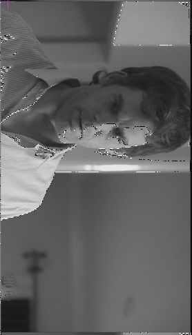

I am using VICP in DM648. resizing video and rotating. (sizing down 0.6)
As you can see in the image below there are artifacts appearing  on bright parts of the image and on gray levels borders.
Changing the saturation limits or the qshift does not help.
Can you help please ?
Nissim

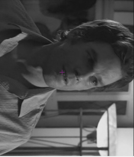

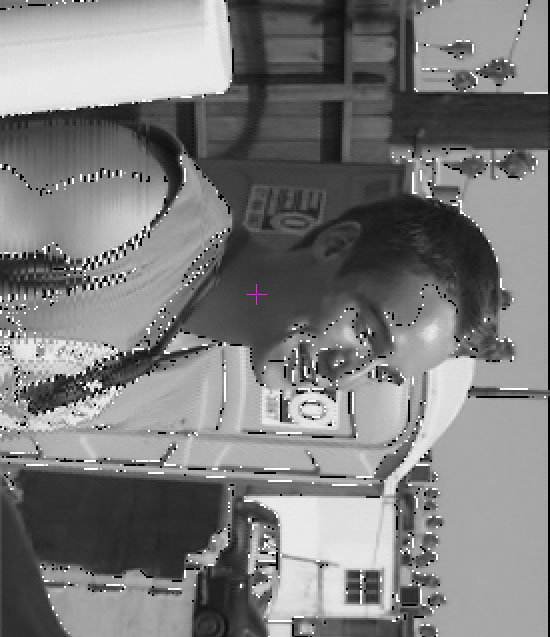

    Regarding the artifacts, I'd advise you to verify with the natural C code GPP_CPIS_affineTransform(), whether the artifacts are still there.
    For the hanging issue, it is likely due to advisory 1.1.5 documented in the errata http://www.ti.com/lit/er/sprz263g/sprz263g.pdf
    Please refer to the paragraph 1.6.2 of http://www.ti.com/lit/ug/sprugj3e/sprugj3e.pdf  to workaround the issue.
    regards,
    Victor
  • Victor
    Thanks for your responce.
    Enclosed please find VICP HW and GPP images. the GPP Image is fine.
    Rotating the Image 90 degrees and resizing by 0.66.
    Using  The same parameters for the GPP and the VICP.
    I will implement the errata recomendations and report back.
    Nissim
