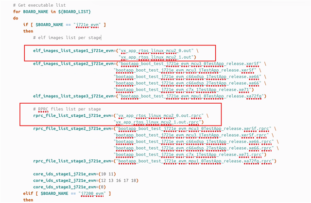

Hello Team,
Currently I am working on the camera sensor bringup(ox02f10).
I am facing the eror while running ./run_app_single_cam.sh.
Please find the detailed log for the same:

     0.000000 s: IPC: ERROR: Unable to create TX channels for CPU [mcu2_0] !!!
     0.000000 s: IPC: Init ... Done !!!
APP: ERROR: IPC init failed !!!
REMOTE_SERVICE: Init ... !!!

     0.000000 s: VX_ZONE_ERROR: [ownContextCreateCmdObj:171] context object descriptor [0] allocation failed
     0.000000 s: VX_ZONE_ERROR: [ownContextCreateCmdObj:174] context object descriptor [0] allocation failed
     0.000000 s: VX_ZONE_ERROR: [ownContextCreateCmdObj:175] Exceeded max object descriptors available.
     0.000000 s: VX_ZONE_ERROR: [ownContextCreateCmdObj:176] May need to increase the value of TIVX_PLATFORM_MAX_OBJ_DESC_SHM_INST in include/TI/soc/tivx_config_j721e.h
     0.000000 s: VX_ZONE_ERROR: [vxCreateContext:1227] context objection creation failed
     0.000000 s: VX_ZONE_ERROR: [ownIsKernelInContext:732] Failed to lock context
     0.000000 s: VX_ZONE_ERROR: [ownGetErrorObject:55] Failed to lock context
     0.000000 s: VX_ZONE_ERROR: [vxGetStatus:1294] Reference is NULL
     0.000000 s: VX_ZONE_ERROR: [vxLoadKernels:225] Publish function for module openvx-core failed
     0.000000 s: VX_ZONE_ERROR: [vxAllocateUserKernelId:2016] Failed to lock context
     0.000000 s: VX_ZONE_ERROR: [tivxAddKernelVpacNfGeneric:436] Unable to allocate user kernel ID
     0.000000 s: VX_ZONE_ERROR: [vxLoadKernels:225] Publish function for module hwa failed
     0.000000 s: VX_ZONE_ERROR: [tivxHwaLoadKernels:162] Failed to load HWA kernels
     0.000000 s: VX_ZONE_ERROR: [tivxAddKernelDisplay:202] Unable to allocate user kernel ID
     0.000000 s: VX_ZONE_ERROR: [vxLoadKernels:225] Publish function for module video_io failed
     0.000000 s: VX_ZONE_ERROR: [tivxAddKernelAewb:312] Unable to allocate user kernel ID
     0.000000 s: VX_ZONE_ERROR: [vxLoadKernels:225] Publish function for module imaging failed
     0.000000 s: VX_ZONE_ERROR: [tivxImagingLoadKernels:132] Failed to load Imaging kernels
     0.000000 s: ISS: Enumerating sensors ... !!!
REMOTE_SERVICE: TX: FAILED: mpu1_0 -> mcu2_0 (port 21) cmd = 0x00000000, prm_size = 384 bytes
     0.000000 s: ISS: ERROR: Enumerating sensors failed !!!

    Steps for creating latepp1:
    i) I have build the build the imaging and vision_apps.
    ii)vx_app_rtos_linux_mcu2_0.out file is generated in ~/ti-processor-sdk-rtos-j721e-evm-11_02_00_06/vision_apps/out/J721E/R5F/FREERTOS/release
    iii)Edit the generate_lateapps.sh file from ~/ti-processor-sdk-rtos-j721e-evm-11_02_00_06/pdk_jacinto_11_02_00_15/packages/ti/boot/sbl/example/boot_app/scriptsas shown below:
    iv)After running this script ./generate_lateapps.sh from the location ~/ti-processor-sdk-rtos-j721e-evm-11_02_00_06/pdk_jacinto_11_02_00_15/packages/ti/boot/sbl/example/boot_app/scriptsand signed
    multicore_MCU2_0_MCU2_1_stage1.appimage.signed file will be generated in ~/ti-processor-sdk-rtos-j721e-evm-11_02_00_06/pdk_jacinto_11_02_00_15/packages/ti/boot/sbl/example/boot_app/multicore_images/j721e_evm and copied into SD card boot partition as lateapp1.
