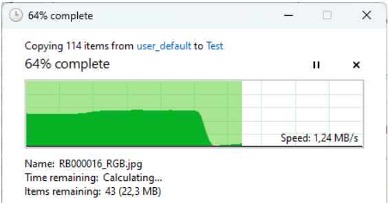

I am using AM6234ATGGHAALW in USB device (mass storage) mode. USB0 is used for this purpose. Whenever device is connected to a Windows laptop USB port (directly and not via a Hub), data transfer speed goes down to almost 0. Host waits for the response from the device. Device seems to be non-responsive and there is a timeout in about 20 seconds. USB reinitializes and restarts the transfer. This issue is not seen when connected via a Hub or to an iOS Host. Also, large number (>200 count) files must be used for this test, in order to reproduce the problem.USB_data_transfer.png

    a bit more details from my side:
    Conditions
    • Happens on many Windows 11 and Linux hosts
    • Happens only when connected without an USB hub
    • Does work on mac books and android devices even without hub
    • Happens on transferring many (tested with 300 - 800) files, never seen with one big file
    • Transfer usually starts fast and stops then at some point

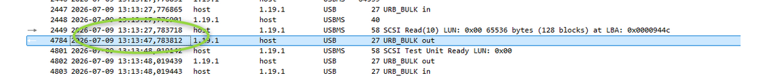

    Analyzes
    Wireshark USB log shows a long time from the read request until the response is coming in:
    Watching the USB state within the device shown that those stalls are aligned with state changes on the USB port. On windows the stall time is about 20sec always as seen on the wireshark log above, while on Linox this is 30sec.

    So either send out packages from the device do not reach the host, or they are not even send because the request did not get received.
    It is very likely that the host ‘resets’ the channel, which is depending on the hostOS done in different timeouts.
