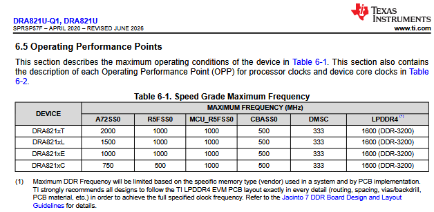

In term of speed grade:
This datasheet table gives different speed grade options:
However the 'orderable part number' (OPN) list only gives two speed grades available as orderable:

  • Hi Anthony,
    Speed grades are linked to device type, and not all are available in every level of safety/security since there would be too many permutations. We also do not publicly display high secure parts, only the general purpose variants. So there are many more parts available than those 2 speed grades you see (when ordering via PO). I can help further over email if there is a particular OPN you are looking for.
    We do not have a tool for automatic configuration depending on variant, it would need to be done manually.
