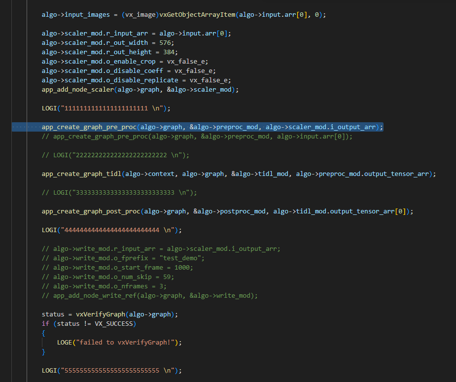

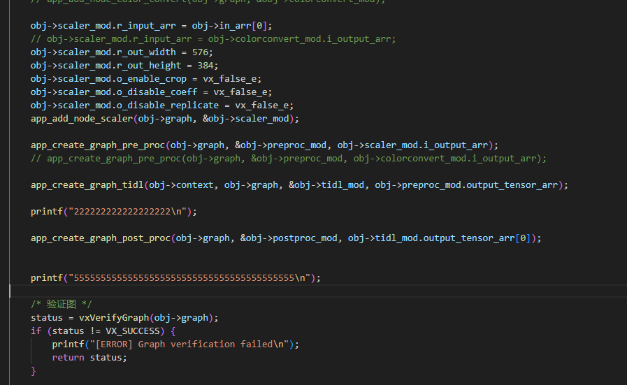

I'm running into an issue. I'm running two apps. One app loads an offline UYVY format image (1920x1536), then uses a scaler node to resize it (576x384), followed by preprocessing (UYVY to RGB tensor), and then sends it to the TIDL node for inference, finally doing post-processing. This app runs continuously without issues.
The second app gets its image data from cameras, with the same resolution and format as the first. If I try to execute the whole process, it freezes at the `vxVerifyGraph` function. If I comment out the TIDL node and post-processing node, it runs fine. We've confirmed that the freeze is caused by the TIDL node, but I don't know why. Could you help me analyze it? For example, could it be due to shared memory or insufficient C7X memory?

    I changed the shared memory size to 512M, below is the app's log
    root@spartan_a:/data/app_online# ./test_algo.out right
    APP: Init ... !!!
       110.464260 s: MEM: Init ... !!!
       110.464370 s: MEM: Initialized DMA HEAP (fd=5) !!!
       110.464576 s: MEM: Init ... Done !!!
       110.464597 s: IPC: Init ... !!!
       110.477285 s: IPC: Init ... Done !!!
    REMOTE_SERVICE: Init ... !!!
    REMOTE_SERVICE: Init ... Done !!!
       110.488650 s: GTC Frequency = 200 MHz
    APP: Init ... Done !!!
       110.488959 s:  VX_ZONE_INFO: Globally Enabled VX_ZONE_ERROR
       110.489048 s:  VX_ZONE_INFO: Globally Enabled VX_ZONE_WARNING
       110.489087 s:  VX_ZONE_INFO: Globally Enabled VX_ZONE_INFO
       110.490295 s:  VX_ZONE_INFO: [tivxPlatformCreateTargetId:169] Added target MPU-0
       110.490664 s:  VX_ZONE_INFO: [tivxPlatformCreateTargetId:169] Added target MPU-1
       110.491046 s:  VX_ZONE_INFO: [tivxPlatformCreateTargetId:169] Added target MPU-2
       110.491446 s:  VX_ZONE_INFO: [tivxPlatformCreateTargetId:169] Added target MPU-3
       110.491511 s:  VX_ZONE_INFO: [tivxInitLocal:202] Initialization Done !!!
       110.491536 s:  VX_ZONE_INFO: Globally Disabled VX_ZONE_INFO
    set the default view as stitched !
    gst cmdline of channel 0: appsrc format=GST_FORMAT_TIME is-live=true do-timestamp=true block=false name=vxsrc ! capsfilter name=filter caps=video/x-raw,width=(int)1280,height=(int)720,framerate=(fraction)30/1,format=(string)UYVY,interlace-mode=(string)progressive,colorimetry=(string)bt601 ! queue name=qe ! v4l2h264enc name=ence extra-controls=enc,prepend_sps_and_pps_to_idr=1,video_bitrate_mode=0,video_gop_size=5,frame_level_rate_control_enable=1,video_bitrate=10000000 ! rtph264pay name=paye ! udpsink name=sink host=172.168.100.214 port=5557
    view_display_front.c[195](info): Query successed and primary is alive
    dirt_algo.c[151](info): TIDL Init Done!
    dirt_algo.c[157](info): Pre Proc Update Done!
    dirt_algo.c[179](info): Pre Proc Init Done!
    dirt_algo.c[184](info): Post Proc Update Done!
    dirt_algo.c[189](info): Post Proc Init Done!
    dirt_algo.c[219](info): 1111111111111111111111
    dirt_algo.c[232](info): 4444444444444444444444444
       113.218299 s:  VX_ZONE_ERROR: [ownContextSendCmd:1001] Command ack message returned failure cmd_status: -1
       113.218355 s:  VX_ZONE_ERROR: [ownNodeKernelInit:704] Target kernel, TIVX_CMD_NODE_CREATE failed for node tidl_node
       113.218376 s:  VX_ZONE_ERROR: [ownNodeKernelInit:705] Please be sure the target callbacks have been registered for this core
       113.218389 s:  VX_ZONE_ERROR: [ownNodeKernelInit:706] If the target callbacks have been registered, please ensure no errors are occurring within the create callback of this kernel
       113.218411 s:  VX_ZONE_ERROR: [ownGraphNodeKernelInit:793] kernel init for node 2, kernel com.ti.tidl:1:1 ... failed !!!
       113.218469 s:  VX_ZONE_ERROR: [ graph_286 ] Node kernel init failed
       113.218484 s:  VX_ZONE_ERROR: [ graph_286 ] Graph verify failed
    dirt_algo.c[244](error): failed to vxVerifyGraph!
    dirt_algo.c[247](info): 5555555555555555555555555
       113.219327 s:  VX_ZONE_ERROR: [tivxNodeSendCommandTimed:346] vxVerifyGraph should be called before tivxNodeSendCommand can be called on a node in the same graph
    dirt_algo.c[252](info): dirt_algo: initialized
    dirt_algo.c[271](info): dirt_algo: registered mailbox at index 0
    dirt_algo.c[271](info): dirt_algo: registered mailbox at index 1
    Starting pipeline run (blocking)...
    Segmentation fault (core dumped)
    ,I used the offline app to load the UYVY image, and then using the same TIDL node, there was no error.
