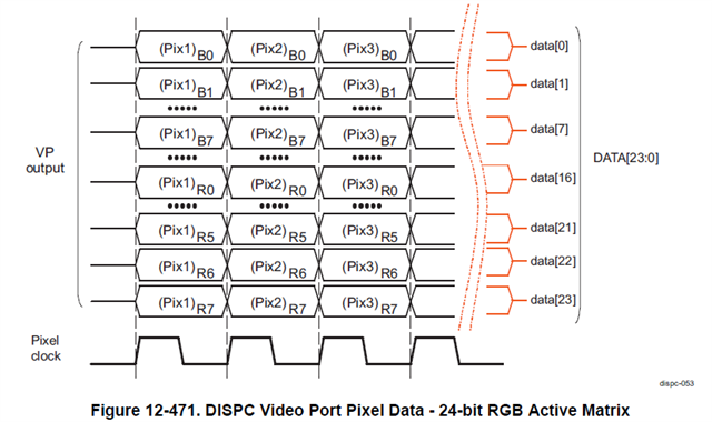

    Referring the AM62Px TRM / Chapter, Display Subsystem and Peripherals / Section, DSS Environment / Section, DSS Parallel Interface / Section, Pixel Data Formats:
    I think that what you state will be true, if BGR888 mapping is selected for a 24-bit pixel output to an active matrix display (8-bit per color coding). In this case each of the 3 different pixels is encoded in a separate byte of the 24-bit VP1/VP2 video port starting from the LSB to MSB and output on the VOUT0_DATA[23:0] corresponding SoC level pins.
    Assuming VP1 output, to configure 24-bit bus data length you should set DSS_VP1_CONTROL[10-8] DATALINES with the respective value, 0x3.
    I think that the appropriate format (with each pixel mapped in exactly one byte and LSB to MSB order B-G-R) which can be selected to match your schematic is highlighted in the below table of the Section, DISPC Functional Description / Section, DISPC Pixel Data Formats from the AM62Px TRM.
     The section describes that the format is selected in the DSS_VID_ATTRIBUTES[6:1] FORMAT bitfield. You should set it to 0xC:BGR24-888.

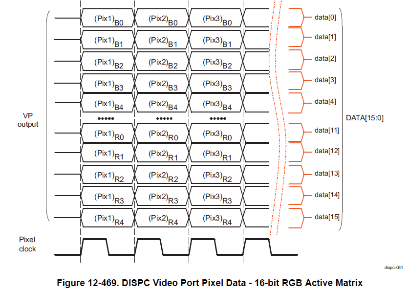

    I think that the DSS hardware allows through the different supported pixel data formats listed above NOT only different pixel ordering (BGR or RGB) but also possibility to have  bits of different pixels (when used bpp < 8 ) within the same VP1 or VP2 byte. I think the mapping is entriely controlled at DSS level and  the DSS0 or DSS1 VP1 / VP2 ports bytes are multiplexed without any SoC level bit re-ordering to the AM62Px VOUT0_DATA[23:0] pins.
    An example is: BGR16-565 in which case I would expect that VOUT0_DATA[16:23] remain unused, because the 3 pixels are fit in exactly 2 bytes:
