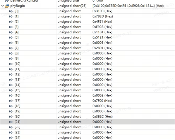

  • Hi  Aaron
    MDIO Registers value is 0x22630000.
    The PHY LINK signal is active‑low. The value of register 0x0E48 is 0x0000000C, and the value of register 0x0E4C is 0x00000008.
    When reproducing the issue, the value of the PHY RX_ERR(phyRegIn[21]) register is 0.
    Understood. So can rule out any changes with respect to the recent fix for PHY Power Down. Also, are you sure that this issue is not observed with the default firmware from ICSDK v2026.00 ? Is the error observed with the patch only?

  • Hi Yijin,
    Couple of clarifications:
    The PHY link is up, but ESC register 0x111 reads 0x56, the port stays closed, and frames are dropped continuously.
    Is this with respect to a single port connection or are both ports connected? In a single port connection, 0x56 is expected (bit8 = 0 which means port0 open, bit9 = 1 which means communication established)
    Are you using LRD/LWR datagrams?
    Aaron
  • Hi Aaron
    Please find the clarifications below:
    1. The issue is reproduced on our hardware.
    2. It can be reproduced consistently, **whether Enhanced Link is enabled or disabled**.
    3. The link signal is active-low.
    4. We are using the Beckhoff SSC demo project.
    5. Only one port is connected. My previous description was not accurate: the port opens normally. The problem is that after the master switches to SafeOP state, the EPU does not process packets correctly and no response packets are returned.
    6. LWR and LRD datagrams are used.
    7. The test environment remains unchanged and is the same as mentioned earlier in this E2E thread.

  • Hi Aaron
    We have tested with the latest firmware. The continuous frame loss issue is fixed, and the subinstance can transition to the OP state normally now.
    When Enhanced Link is enabled:
    - The IN port link loss counter in register 0x310 is correct.
    - The OUT port link loss counter shows abnormal behavior. Its value increases substantially upon each cable plug/unplug action.
    When Enhanced Link is disabled:
    - Both IN and OUT port link loss counters in register 0x310 work properly.
    We hope this can be resolved as soon as possible. Thank you.
