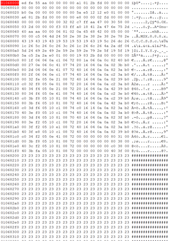

AM62A3: When receiving MIPI data, the MIPI CSI-2 on AM62A3 occasionally encounters a DMA TR EXCEPTION error.
Part Number: AM62A3
I am currently configuring the MIPI format to 2240x480, and most of the time I can receive normal data frames. Occasionally, after submitting a DMA TR (Transfer Record) request, the DMA interrupt is triggered immediately and the callback is invoked instantly, placing the buffer into the done list. However, when executing deqbuf in user space, I find that the data in the buffer remains old.
To debug this issue, I modified the kernel driver by replacing the DMA callback with callback_result and adding a status member to dma_result to obtain the DMA transfer result. After running and reproducing the issue with the modified kernel, I found that the error code recorded in status is 5, which corresponds to CPPI5_TR_RESPONSE_STATUS_TRANSFER_EXCEPTION.
Could you please help confirm under what circumstances this error occurs?

    Could you please check why the TR data isn't correct? Any data crash happens?

  • Hi Linjun,
    Here is the wrong frame data we captured
    according to this wrong frame data, only first 512 bytes were overwrited by DMA TR,
  • another log, seems that the 512 byte is a clue
  • Dear    .
    here is update from customer:
    1. Seyond team has reproduced the issue last night and provided register dump and kmesg log, I attach register dump and kmesg log again in this post for easy review.
    2. Seyond team found it seems UDMA has received right 512B data when issue happens as first 512Byte data is not the pattern data 0x23.
    3. Seyond team also simplified the system to do CSI-RX receiving ONLY. then the issue still can be reproduced, but it costs long time than before.
    4. Seyond team will add Jay's debug patch and reproduce the issue. Please let us know if need more except register dump and kmesg log.
    5. Seyond team has one board that easy to reproduce this issue in lab. would you please help arrange an on-line debug session with customer for further debug?
