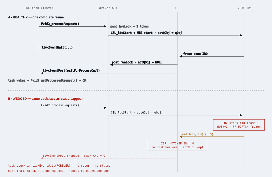

We are testing our application using the TI VHWA M2M LDC driver and have observed an issue when the LDC HTS watchdog fires. After the watchdog timeout, the LDC stops making forward progress while processing a frame, and the application waits indefinitely for the request to complete.

Based on these observations, the LDC appears to stop making forward progress after the watchdog timeout while remaining BUSY, and the current request never completes.
For reference, we have attached a sequence diagram illustrating the observed execution flow in both the normal case and the watchdog timeout case.

  • Thank you, Jianzhong. I appreciate the update and your efforts in discussing this internally.
    We already have an external watchdog in our system. However, in this scenario it does not fire because the LDC hardware waits indefinitely for completion without blocking the CPU. The software thread remains alive and continues to service the external watchdog, so the system never resets even though the LDC request is permanently stalled.
    Therefore, we're looking for a way to recover the LDC/HTS from this "wait forever" state without requiring a full system reset.
