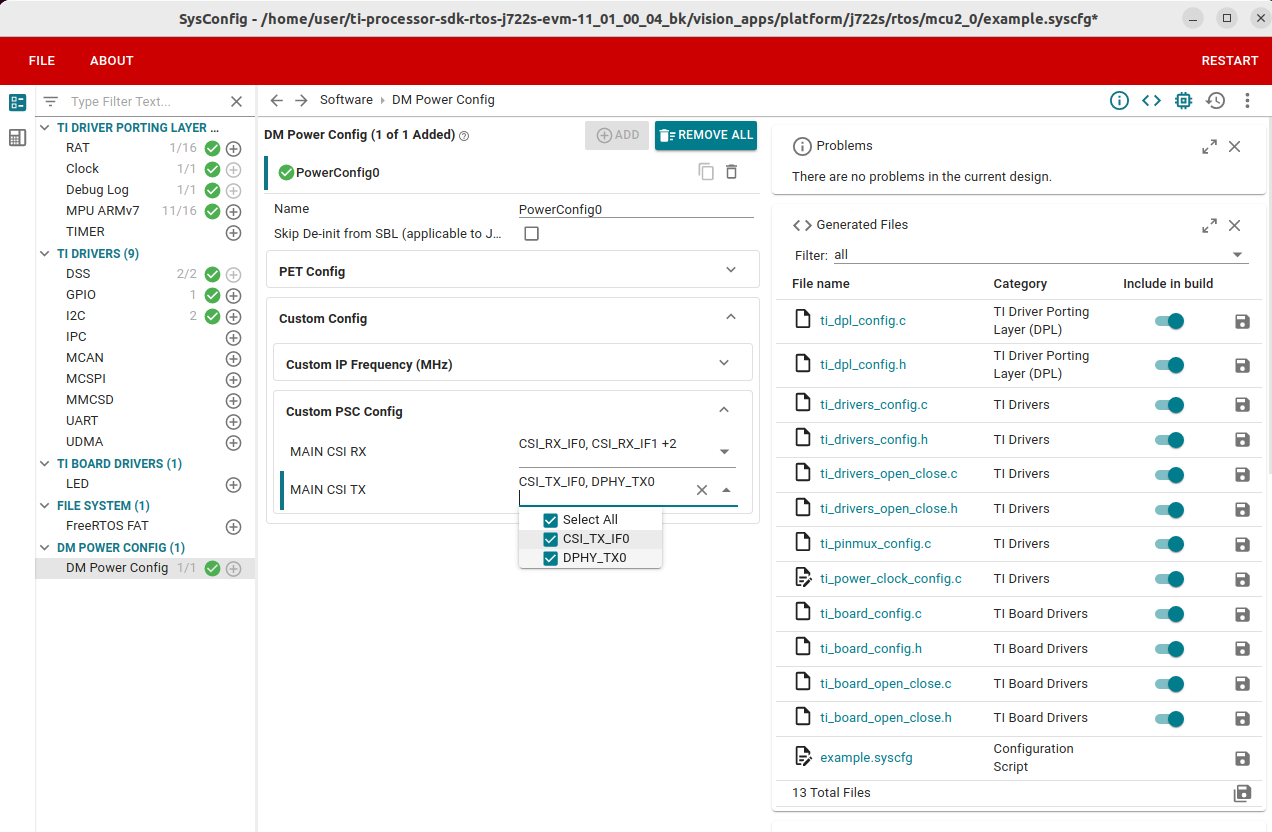

However, when implementing CSITX inside vision_apps, I am unsure whether the following SysConfig settings must also be enabled.
  • MAIN CSI TX
    • CSI_TX_IF0
    • DPHY_TX0
(Please refer to the attached screenshot.)

  • Hi Masao,
    Checked with the team that for CSITX, sysconfig configuration is not required.
    Brijesh

    I understand that sysconfig settings are not required for CSITX. I would like to confirm one more point.
    I thought that enabling it in syscfg would initialize the registers related to DPHY_TX0/CSI_TX_IF0 and make them available, but I understand that this is not necessary. Is it correct to understand that the initialization control for using DPHY_TX0/CSI_TX_IF0 is performed when using the CSITX API?
    Also, in the Linux device tree, the setting for dphy_tx0 is set to status = "okay" by default. Is it okay to leave this setting as "okay"?

  • Hi Brijesh,
    Is it also acceptable to keep the following two settings disabled?
    • CSI TX ESC CLK
    • CSI TX MAIN CLK
    Masao Takayama
  • Hi Masao,
    Yes, that's fine.
    Brijesh
  • Hi Masao,
    Yes, the module registers will be configured and taken care by the CSITX driver. sysconfig in this case can be used for configuring pinmux, but i think that's also not required, because typically these pins are dedicated for CSITX functionality.
    no, please disable any function related to CSITX from the Linux, as CSITX will be used from R5F in your case.
