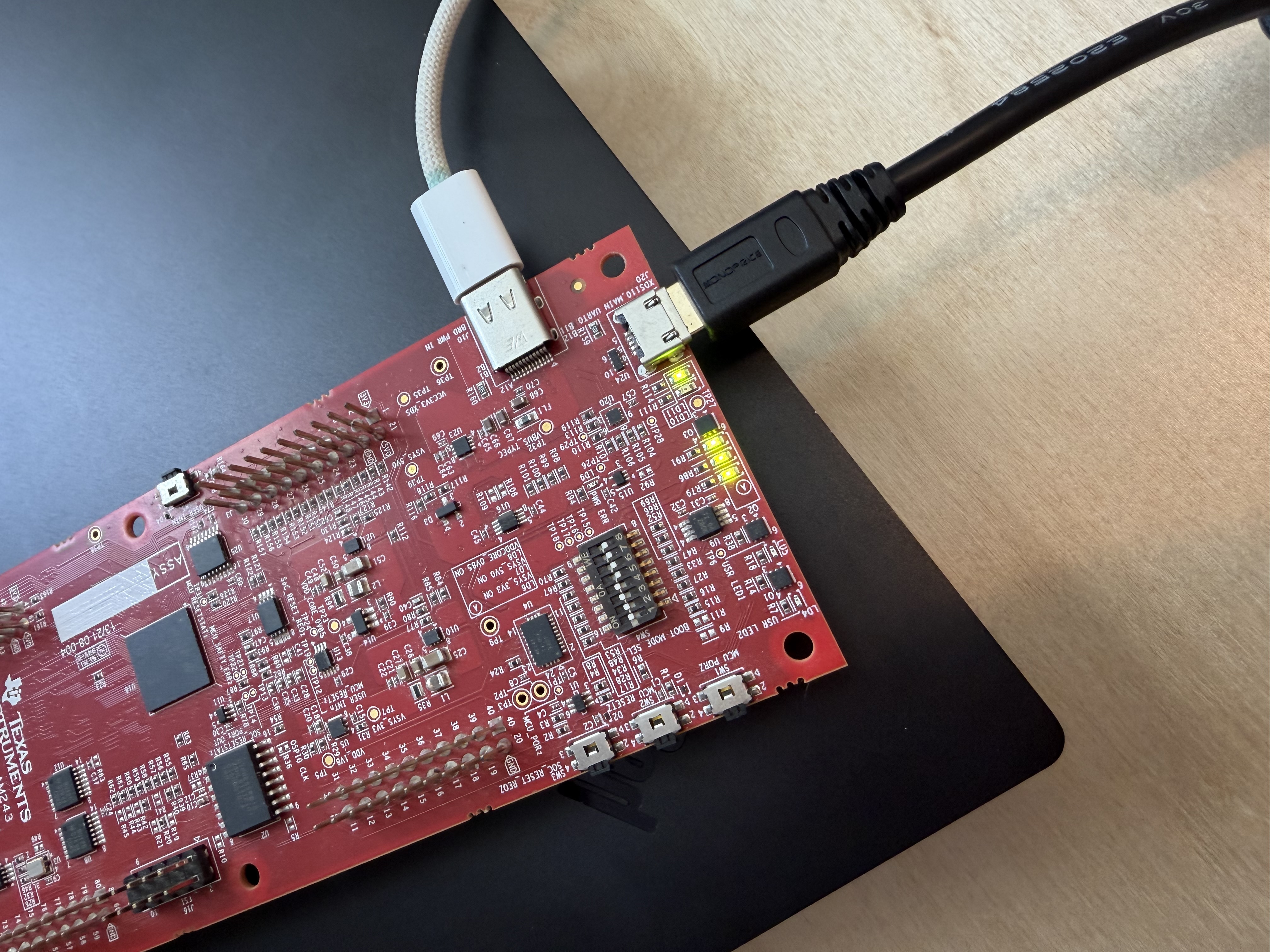

AM2434: Unable to flash sciclient_ccs_init.release.out
Part Number: AM2434
I am unable to load the sciclient firmware to unlock the AM24 for debug.
I saw the FAQ and followed the steps:

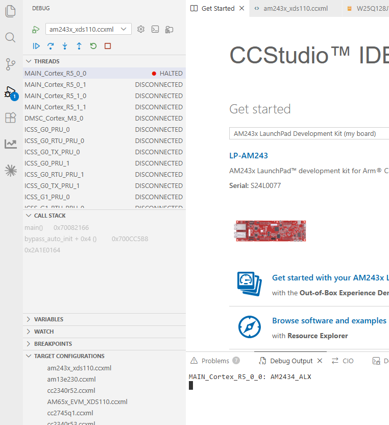

  1. put device in dev boot mode:
2. Connect to main R5 core:

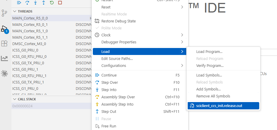

4. Load sciclient_ccs_init.release.out

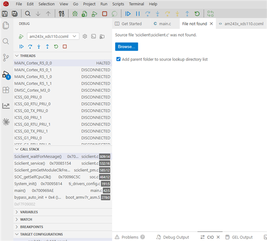

6. Run: Note no CIO output
7: Pause debugger looks like it's stuck on waiting for the clocks to initialize:

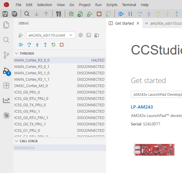

7. Leave running and the processor has crashed/ is off in no mans land:
I did just in case the CIO wasn't working try restarting the debug session and loading an application binary to the CPU. It also does not run and is stuck on Sciclient_waitForMessage():
Please advise.
