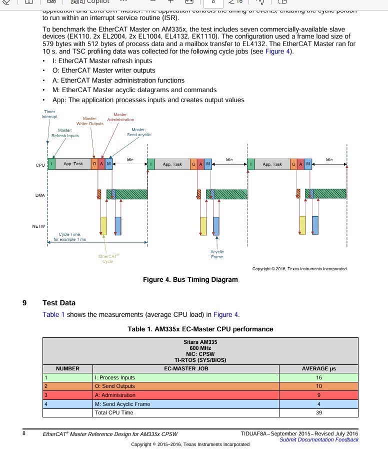

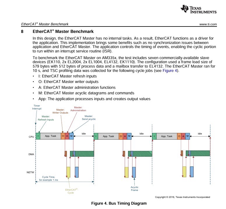

My customer is asked for EC report same as AM335, but i didn't find on AM6442 website.
The report example as below attachment
