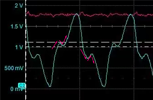

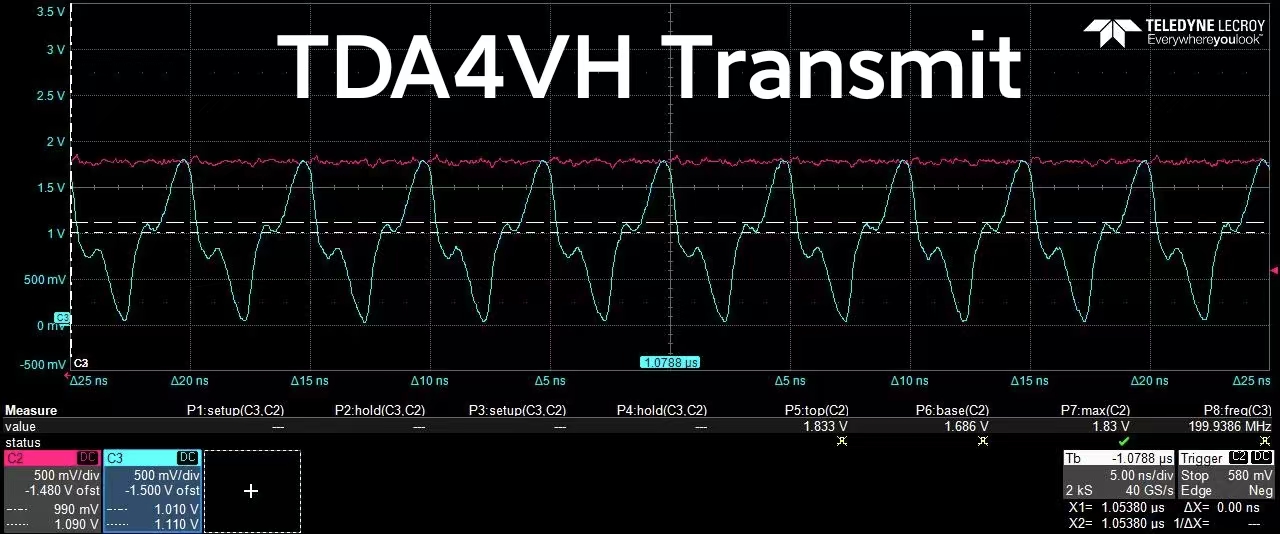

eMMC_CLK is not used as re-timing on TDA4VH (same as AM6x), will the hookback on SOC side cause problem? confirmed the SI on eMMC side is good.
SOC side:
Far end on eMMC side:
Hi Tony,
I'm unsure what your question is. What do you mean by hookback?
Regards,Mark
Hi Mark,
Sorry for causing confuse. it means the signal rising/fall edge non-monotonic. If it cause problem?
And is eMMC_CLK used as re-timing on TDA4VH?
Thanks for the clarification.
No, this will not cause a problem. The eMMC PHY handles the IO clock loopback internally.
