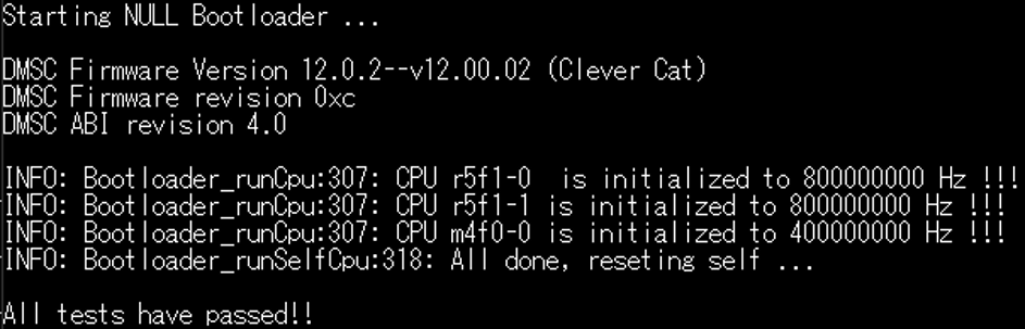

When we use SBL "sbl_null.release.hs_fs.tiimage" for developing, the application runs successfully.
However, after we flashed the image to OSPI flash and changed SBL to "sbl_ospi.release.hs_fs.tiimage", the application doesn't work.
No more responses after switching to the application.

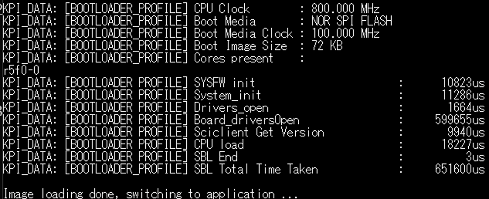

    In DEBUG mode, I can see the logs from the OSPI Flash IO example after the SBL OSPI has completed its execution.
    Although I built example in DEBUG mode, I can't see any log after SBL OSPI. I tried SBL "sbl_ospi.release.hs_fs.tiimage" and "sbl_ospi.debug.hs_fs.tiimage" but both failed. Could you help me look into this?

    It's the default Flash part on LP board and the process of flashing DEBUG mode images was successful.
    But the application still fails to output any logs after SBL completed in both cases.
    sbl_ospi.debug.hs_fs.tiimage :
    sbl_ospi.release.hs_fs.tiimage :

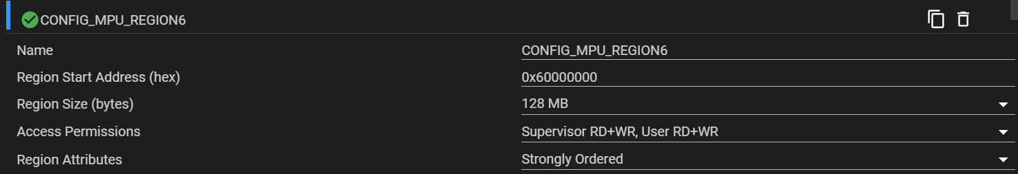

    mpu_armv76.$name      = "CONFIG_MPU_REGION6";
    mpu_armv76.baseAddr   = 0x60000000;
    mpu_armv76.size       = 27;
    mpu_armv76.attributes = "Device";

    Attached is the SysConfig file from enet_icssg_tcpserver_am243x-lp_r5fss0-0_freertos_ti-arm-clang. I changed the MPU CONFIG_MPU_REGION6 attribute from "Cached" to "Strongly Ordered" for OSPI Flash read/write operations.
    Once flashed to OSPI Flash and booted via SBL OSPI, there is no UART output after the SBL switches to the application.
    BR,
    Harry
  • Hi Harry,
    Thanks a lot for providing these details. Please give me time till Monday to review this and try replicating the issue on my end.
    Also, yes, your MPU region configurations are correct, since "Strongly Ordered" is used for OSPI Flash read/write operations.
    Aryamaan
