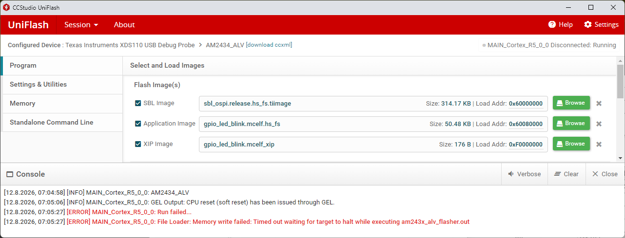

But after that, when I change to OSPI as described in the next steps, I didn't see the Starting NULL Bootloader ... message via UART. I restart the board and even the computer, but I had no success.
I am not able to connect to debug/flash any program via CCS. I always get the following error:
MAIN_Cortex_R5_0_0: AM2434_ALV
MAIN_Cortex_R5_0_0: Trouble Writing Memory Block at 0x0 on Page 0 of Length 0x40: (Error -1065 @ 0x40) Unable to access device memory. Verify that the memory address is in valid memory. If error persists, confirm configuration, power-cycle board, and/or try more reliable JTAG settings (e.g. lower TCLK). (Emulation package 20.5.0.3920)
MAIN_Cortex_R5_0_0: File Loader: Verification failed: Target failed to write 0x00000000
MAIN_Cortex_R5_0_0: GEL: File: A:\ccstudio_workspaces\nomal_workspace\gpio_led_blink\Release\gpio_led_blink.out: Load failed.

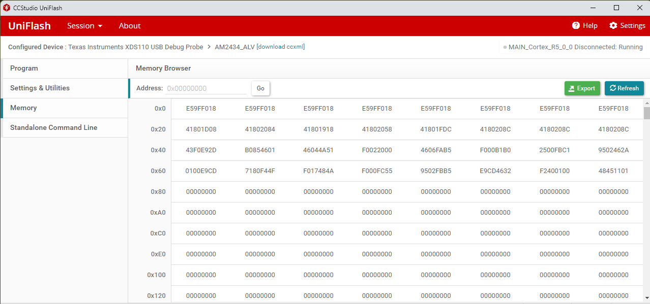

And with UniFlash I can read the memory
But I can not flash any image
I tried to repeat the Flash SOC Initialization Binary with the sbl_null configuration and also with the sbl_ospi. The problem persists.

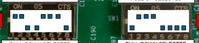

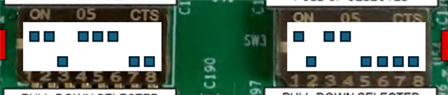

    boot switch configuration during the flashing process:
    at the boot time: with UART as a Backup Boot Mode. Results without backup boot mode are the same
    I still have the same problems, so far no  Starting NULL Bootloader ... message on Serial Console

    Just after running py uart_uniflash.py -p COM7 --cfg=sbl_prebuilt/am243x-evm/ti_special.cfg I can see different values on the memory:
    But when I turn off the board, change the boot mode and turn on the board again, the memory always shows what I posted in the question. I was also able to flah an example code by using py uart_bootloader.py -p COM7 --cfg=sbl_prebuilt/am243x-evm/default_sbl_uart.cfg. Does the ROM fails to find the SBL?

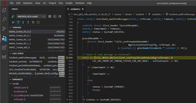

  • Frist thing I did:
    I can't connect load sciclient_ccs_init.release.out as described in the second link. What I did before that to be able to load it was to use py uart_bootloader.py -p COM7 --cfg=sbl_prebuilt/am243x-evm/default_sbl_uart.cfg to load the empty example from TI and only after that I'm able to connect to load the file. However, when I run it as described in the second link, there is no output in the CIO console. And after I restarted the device, the problem was still the same.
    Second thing I tried:
    I then tried with the frist link by compiling the code and loading the .out file. Again, this is only possible if I first load an empty project via UART. The code was running and I was able to interact as described in the documentation and everything was performed successfully. However, after I restarted the evaluation board, the problem was still the same.
    Third thing I tried:
    I then did the same thing as before, but with sbl_null. The code always get stucked here:
    Main points:
    1. I can connect to all cores and load/debug code via CCS, if I load an empty project before via UART with py uart_bootloader.py -p COM7 --cfg=sbl_prebuilt/am243x-evm/default_sbl_uart.cfg. If I don't do that I can only connect to core r5_0_0 and r5_0_1, and for the rest of the cores I get this messages:
      MAIN_Cortex_R5_1_0: Error connecting to the target: (Error -1170 @ 0x0) Unable to access the DAP. Reset the device, and retry the operation. If error persists, confirm configuration, power-cycle the board, and/or try more reliable JTAG settings (e.g. lower TCLK). (Emulation package 20.5.0.3920)
      MAIN_Cortex_R5_1_1: Error connecting to the target: (Error -1170 @ 0x0) Unable to access the DAP. Reset the device, and retry the operation. If error persists, confirm configuration, power-cycle the board, and/or try more reliable JTAG settings (e.g. lower TCLK). (Emulation package 20.5.0.3920)
      BLAZAR_Cortex_M4F_0: Error connecting to the target: (Error -1274 @ 0x0) Error encountered during connect sequence. The specific reason is unknown but may be the result of trying to access a Core or logic that is inaccessible due to a lack of Power, Clocks, or Authentication (i.e. Security is preventing). If blocked by security, and if supported, access may be allowed after following the Authentication process. (Emulation package 20.5.0.3920)
    2. If I don't pre load the empty project I can still load/debug sbl_null.out and sbl_jtag_unifalsh.out, but I can't load any other .out file, not even sciclient_ccs_init.release.out. One interesting point for me is that in the .map of those to file it says ENTRY POINT SYMBOL: "_vectors_sbl"  address: 70000000, while that adress is 00000000 in all other examples
    3. Using sbl_jtag_unifalsh.out is only possible if I preload the empty example via UART. Otherwise I can load it, but it get stucked here
