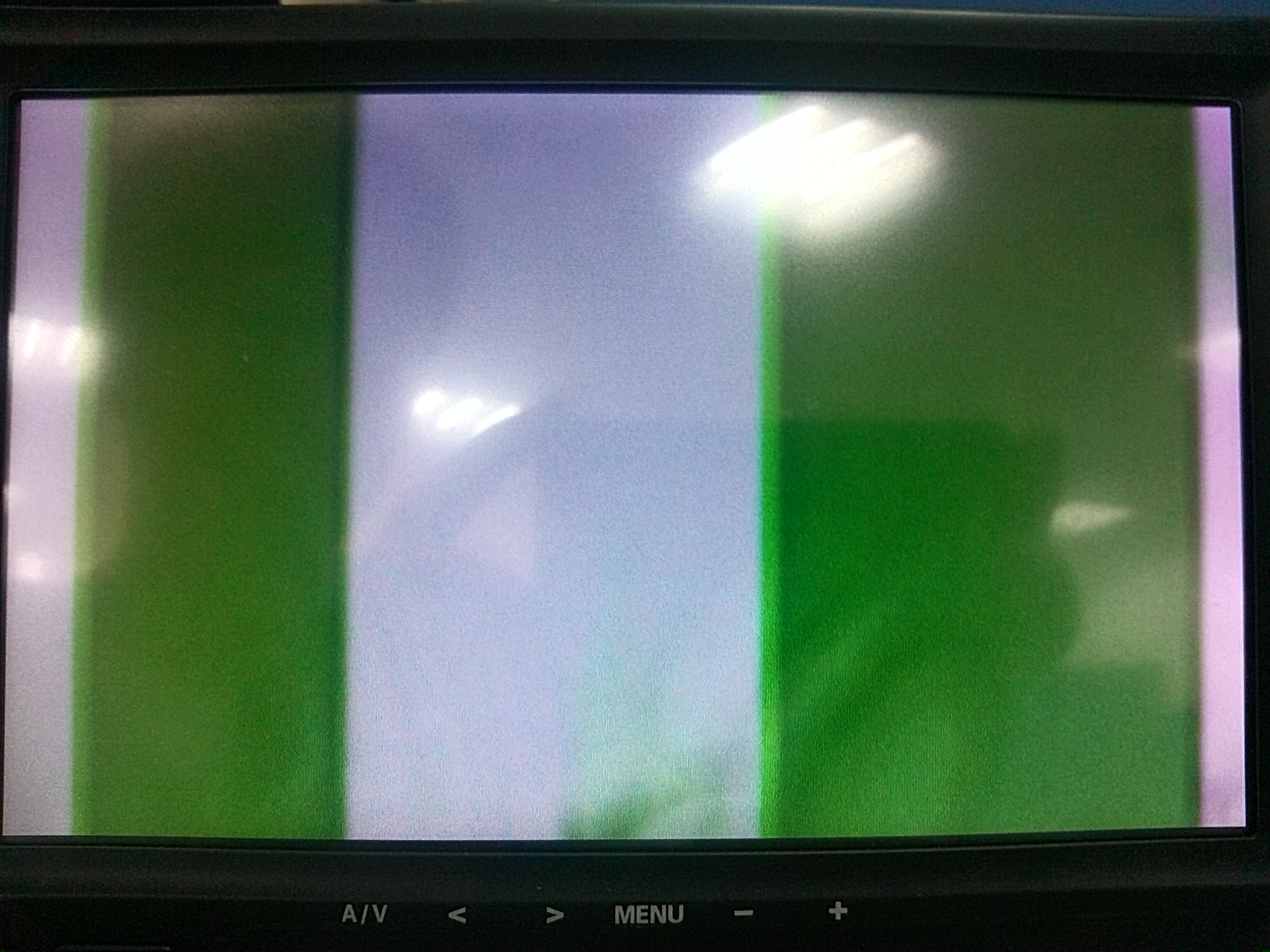

Varying the OMX_PARAM_VFCC_HWPORT_PROPERTIES.eScanType and OMX_PARAM_VFCC_HWPORT_PROPERTIES.nMaxHeight parameters produces the following results:
Condition 1:
OMX_PARAM_VFCC_HWPORT_PROPERTIES.eScanType = OMX_VIDEO_CaptureScanTypeInterlaced
OMX_PARAM_VFCC_HWPORT_PROPERTIES.nMaxHeight = 243
The image shows as a monochrome (green) images with a second image shadowed as if the second frame is several lines off and incorrectly sized.  Some white and purple shading occasionally appears in the shadow image.  The lower half of the image has a green shading that appears to be additional lines.

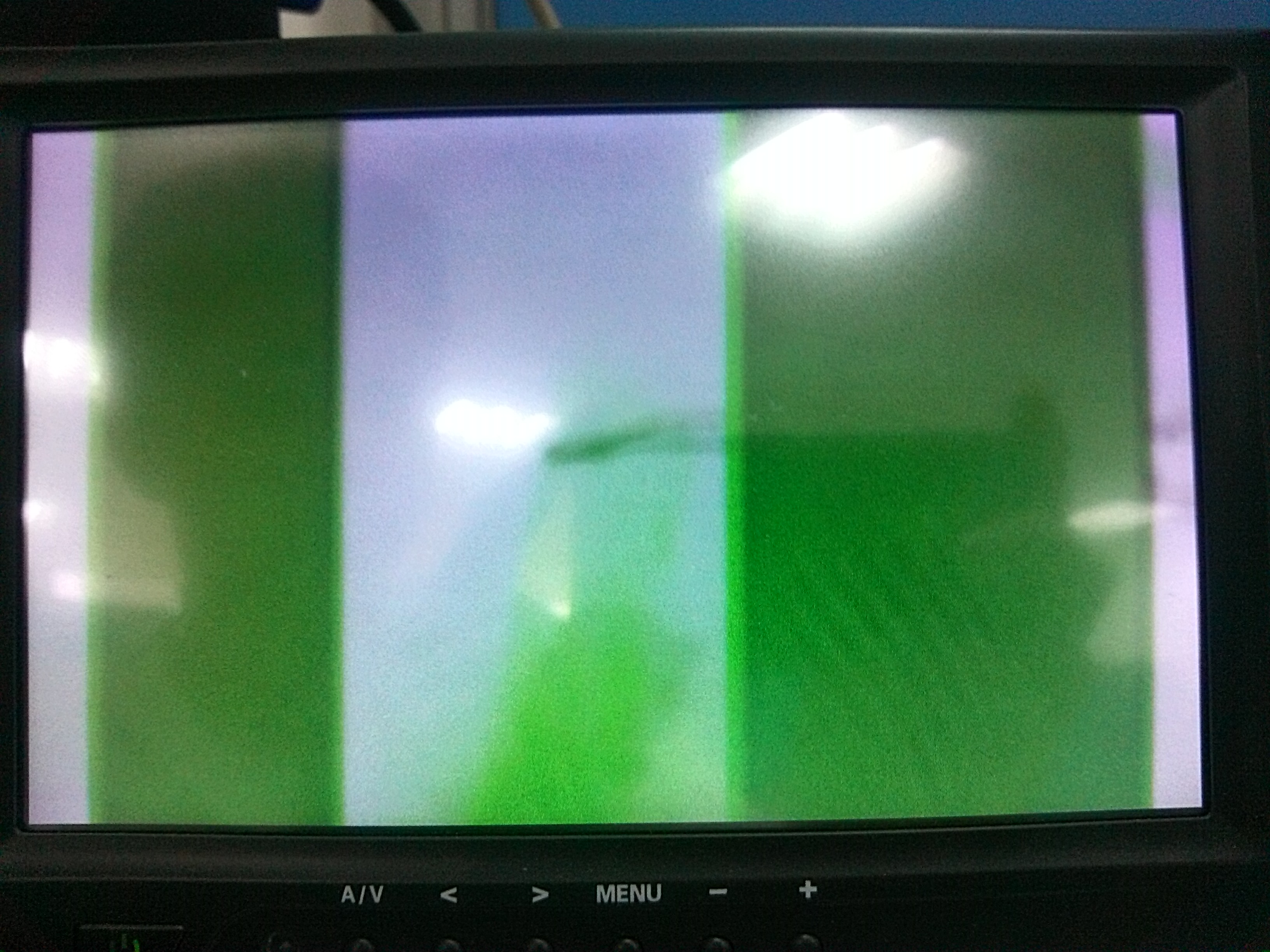

Condition 2:
OMX_PARAM_VFCC_HWPORT_PROPERTIES.nMaxHeight = 486
The image is similar to condition 1 except the green shading on the lower half of the screen is not present.
condition 3:
OMX_PARAM_VFCC_HWPORT_PROPERTIES.eScanType = OMX_VIDEO_CaptureScanTypeProgressive
The screen is split horizontally into two halves with the top showing a shadowed monochrome image and the bottom showing a monochrome (green) version of memory data (doesn't trace the current image)
condition 4:
The screen is split horizontally into two halves with the top showing a clean full-color image and the bottom still showing  a monochrome (green) version of memory data (doesn't trace the current image).
  • Since the original post we have verified the settings on the TI decoder chip (TVP5151) using the eval board for the 5151 and used the original settings from the 5151 eval board in our system with the same results.  These settings differ only in the test signals brought out of the 5151.
    This problem appears to be the OMAX VFCC component not working with interlaced input.

    In the TI EVMs we have TVP7002. Setting the scan type to interlaced and height as 243 (half) is correct for having interlace capture. We have tried the same for TVP7002 1080i capture on TI 8168 EVM + EIO card..
    Have you modifed DEI settings as well for input height as 243, and algbypass is set to zero , so that de-intelacing is enabled ?

    I have made several changes
    1. add OMX_VIDEO_DECODER_STD_1080I_60 and several other changes to support "-m 1080i" in the command line
    2. set capture o/p height and dei i/p height and the buffers corresponding to them.
    3. set eScanType to Interlaced
    4. set algEnable.bAlgBypass = 0 to disable bypass mode
    5.set height for input chresolution and cropheight to 540
    Then I run commands below.
    # /etc/init.d/matrix-gui-e stop
    # /etc/init.d/pvr-init stop
    # ./capture_encode_a8host_debug.xv5T -o sample.h264 -m 1080i -f 60 -b 1000000 -n 1000
    But what I get is only the upper part of the video.
    while the whole picture is
    Could you please tell me what mistake I have made?
    Thanks very much!
