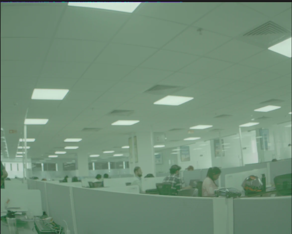

Took a vlc stream and observed that the stream has a green tint to it.
We also too raw_dump and converted it using the Chromatix application  and in that case the image is like this.
We thing the issue is with the demosacing and that is coming in the dcc_viss_wdr.bin that we have included in the pipeline.
Since we are using tiovxisp we need help from your side to resolve this issue.

  • Hi Tina,
    The binaries generated by the Python script based on your ox03h10_properties.txt don't have the right AWB gains. You'll need to perform AWB tuning to get the color correct.
    Jianzhong

  • Hi Tina,
    Is there any default binaries that you can provide, for this sensor to get a better image with atleast lesser green tint
    No, we don't have tuning binaries for OX03H sensor.

  • Can you explain what you mean by the WDR_KNEE_X and WDR_KNEE_Y parameters
  • we have also observed that when we take stream indoor and outdoor there is change in green tint.
    we hope to understand what exactly is the issue that is causing this green tint
    Please refer to the following section in AM62A TRM.
    You need to tune auto exposure control and auto white balancing.

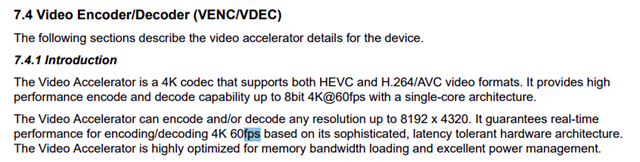

  • While checking the TRM document i noticed this
    So your encoder supports 8bit @6fps for 4K resolution,
    So the bit step down along with other thing is taken case of by the ISP.
    In that case can the buffer scheduling be the casue of this frame jump being observed in the 60fps where as not observed in 30fps setup?
    Because our spec is 12bit 1920x1536(3mp) @60fps.
    Please confirm if this finding is correct and is the reason for the frame jump that is observed in 60fps

    Another thing unrelated to the frame jump, I see the pictures are greenish. Are you using WDR mode from the sensor? If that's the case, you'll need to enable WDR processing for the ISP by adding "wdr-enabled=true" to tiovxisp. For example,
    tiovxisp sink_0::device=/dev/v4l-subdev4 \
    sensor-name=SENSOR_OX03H10 \
    dcc-isp-file=/root/dcc_viss_wdr.bin \
    sink_0::dcc-2a-file=/root/dcc_2a_wdr.bin \
    format-msb=11 wdr-enabled=true sink_0::pool-size=8 src_0::pool-size=8
