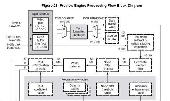

  • This is the preview engine flow from the VPFE guide.
    I find that at the beginning if the sensor raw input is send to CCDC  ,the raw data should be 10 bits.
    Is that correct ? Or it can be 8~16 bits per pixel ?
    If the input has to be 10 bits ,the original configuration ( 8 bits ) in the preview on the fly sample is wrong ?

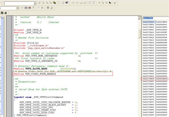

  • Strangely , the memory at 0x01c70458 is the FMTCFG
    When I run the code ,it shows 0x00004000.
    I look up the CCDC FMTCFG register ,the 15th bit should be 1 ,and the video port could be enable then.
    It seems the video port are disable now......
    BTW .the #define PSP_VEDIO_PATH_ENABLE is enable in this way ,right ?
