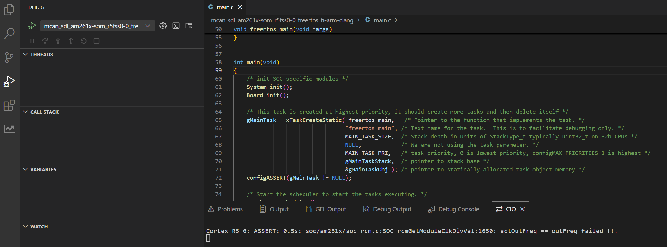

  • 1. I had downloaded the next SDK and tried with DFU flash of mcan_sdl_am261x-som_r5fss0-0_freertos_ti-arm-clang.mcelf into the LaunchPad board.
    The UART log also showed the same that some tests failed.
      default_dfu_ospi.cfg
    2. I tried DEV-BOOT mode with 400MHZ, using CCS to load the program into the LaunchPad board.
    It gets stuck here.

  • Hi Wang,
    From your screenshot i could see you are testing this example in Dev boot mode.
    However, in below steps to test example, they clearly mentioned that this example should need to be test in QSPI/OSPI boot modes.
    So, i would suggest you test in that method once and provide me an update.
    Thanks & regards,
    Jagadish.

  • Hi Wang,
    So now I would like to understand which dependencies within SBL are required to support SDL execution.
    Not all the examples of SDL, most of the examples will work without SBL only. Only the testings which have dependency with CCM has to be work with SBL (Integrated example also involves CCM).
    CCM test is sensitive to the R5F core and its execution environment.
    When you run the application directly through CCS in dev boot mode:
    • The debugger can initialize parts of the device.
    • The CPU may not go through the same reset/release sequence as in a real boot.
    • The debugger can halt the R5F which is particularly undesirable in CCM (Core Compare Module) testing
    These are some reasons we should not perform this particular test in dev boot mode. Apart from these remaining testings can be work through dev boot mode as well.

  • Hi Wang,
    I was able to reproduce your issue at my end and then i made few changes in sysconfig(related to board), and now the example is working without any issues at my end on my AM261x Launchpad.
    Here is my project for your reference:
    mcan_sdl_am261x-som_r5fss0-0_freertos_ti-arm-clang.zip
    Thanks & regards,
    Jagadish.
