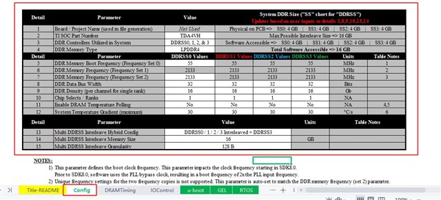

  • ddr_par.zipIt was generated using the excel tool SPRACU8B_jacinto7_DDRS_RegConfigTool, whose version number is 23rd,2023, 0.10.0 this is our ddr parameter,
  • the ddr_par.zip is our ddr parameter,It was generated using the excel tool SPRACU8B_jacinto7_DDRS_RegConfigTool, whose version number is 23rd,2023, 0.10.0 , we just change the chip selects/ranks from 2 to 1,and multi DDRSS interleave memory size from 32GB to 16GB

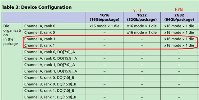

    I has compared your hardware used  MT53E1G32D2FW-046 AAT:C with EVM board used MT53E2G32D4DE-046. They are same die but 1G32D2 just has 1 Rank and EVM board 8GB 2G32D4 has 2 Rank.
