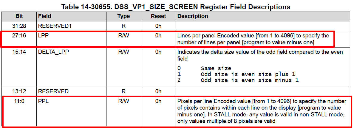

#2. Max line size and lines:
#2.1. The LPP and PPL field are 12bit, supports 4096 lines and 4096 pixel per line, the line of  1920x1080@60fps should be 4096x4096 to state the max resolution supported by specification.
 #2.2. The next line specified the real use case given DDR bandwidth, it is doesn't give fps, it is not rigorous and cause confusing.

    Q2. Max line size and lines:
    Q2.1
    The register fields confirm:
    • LPP (bits 27:16, 12-bit field): supports values 1 to 4096 lines per panel
    • PPL (bits 11:0, 12-bit field): supports values 1 to 4096 pixels per line
    So the hardware register capability is 4096×4096, and the "1920×1080@60fps" is indeed just one validated use-case example, not the hardware maximum. In the AM62x TRM /  Section, DISPC VP Timing Generator and Display Panel Settings confirms both fields support "a value from 1 to 4096".
    The datasheet's statement of "1920×1080@60fps" as a feature bullet is a representative use case, while the actual register max is 4096×4096.
