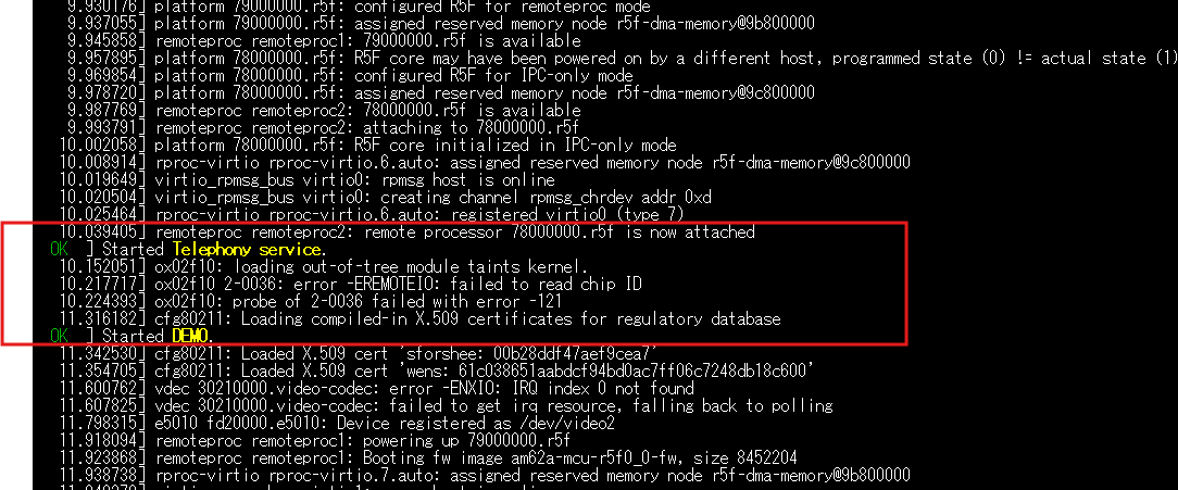

root@am62axx-evm:/# dmesg | grep -i ox02
[   10.152051] ox02f10: loading out-of-tree module taints kernel.
[   10.217717] ox02f10 2-0036: error -EREMOTEIO: failed to read chip ID
[   10.224393] ox02f10: probe of 2-0036 failed with error -121
root@am62axx-evm:/# dmesg | grep -iE "ox02|camera|probe|i2c"

[    4.897776] systemd[1]: Created slice Slice /system/modprobe.
[   13.163341] cdns-csi2rx 30101000.csi-bridge: Probed CSI2RX with 4/4 lanes, 4 streams, external D-PHY
[   23.489135] platform 30200000.dss: deferred probe pending
root@am62axx-evm:/#
Please guide how to bringup teh camera sensor.

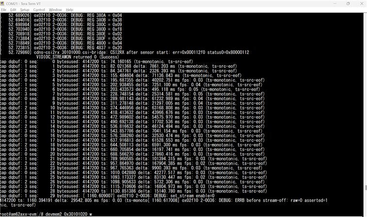

  • Hello  ,
    Thanks a lot for your information!!
    I have implemented the drive and ran some of the commands. so as per that sensor is detected successfully.
    Now streaming is not happening.
    Kindly check and please support for regarding the same. If you need any further information required i am happy to share.

    Unable to setup formats: Inappropriate ioctl for device (25)
    OX02F10 Camera 0 detected
    device = /dev/video-ox02f10-cam0
    name = ox02f10
    format = [fmt:SRGGB10_1X10/1920x1080@1/30 field:none]
    subdev_id = /dev/v4l-ox02f10-subdev0
    isp_required = yes
    terminate called after throwing an instance of 'std::runtime_error'
    what(): failed to find DRM cards
    root@am62axx-evm:/opt/edgeai-gst-apps#
    [ 12.059621] ox02f10: loading out-of-tree module taints kernel.
    [ 12.067283] ox02f10 2-0036: DEBUG: power_on entry
    [ 12.072087] ox02f10 2-0036: DEBUG: xclk enabled, rate=24000000
    [ 12.117496] ox02f10 2-0036: DEBUG: power_on complete
    [ 12.137817] ox02f10 2-0036: detected OX02F10, chip ID 0x5803
    [ 13.983067] ox02f10 2-0036: Consider updating driver ox02f10 to match on endpoints
    [ 13.994977] cdns-csi2rx 30101000.csi-bridge: Probed CSI2RX with 4/4 lanes, 4 streams, external D-PHY
    [ 24.255671] platform 30200000.dss: deferred probe pending

  • Hello  ,
    Thank you soo much for your support!!
    Now the driver is setting the default format. streaming is not happening i.e 30fps as per the requirement.
    Please find the attached detailed log for same and attached driver file for the same to review the changes. Regarding the Sensor registers, i have taken from the TI code.
    Sensor registers: https://git.ti.com/cgit/processor-sdk/imaging/tree/sensor_drv/src/ox02f10/ox02f10_sensor_config.h?h=ov_drivers
    Ox02f10 updated driver code:

    root@am62axx-evm:/# dmesg | grep -Ei 'ox02f10|csi'
    [ 0.521310] SCSI subsystem initialized
    [ 0.890581] Block layer SCSI generic (bsg) driver version 0.4 loaded (major 244)
    [ 13.946692] ox02f10: loading out-of-tree module taints kernel.
    [ 13.958534] ox02f10 2-0036: DEBUG: power_on entry
    [ 13.971966] ox02f10 2-0036: DEBUG: xclk enabled, rate=24000000
    [ 14.029005] ox02f10 2-0036: DEBUG: power_on complete
    [ 14.062319] ox02f10 2-0036: detected OX02F10, chip ID 0x5803
    [ 16.915976] ox02f10 2-0036: Consider updating driver ox02f10 to match on endpoints
    [ 16.978972] cdns-csi2rx 30101000.csi-bridge: Probed CSI2RX with 4/4 lanes, 4 streams, external D-PHY

    root@am62axx-evm:/# v4l2-ctl -d /dev/video-ox02f10-cam0 \
    > --set-fmt-video=width=1920,height=1080,pixelformat=RG10
    root@am62axx-evm:/# v4l2-ctl -d /dev/v4l-subdev2 --list-ctrls
    User Controls
    exposure 0x00980911 (int) : min=1 max=584 step=1 default=391 value=391
    Image Source Controls
    analogue_gain 0x009e0903 (int) : min=0 max=255 step=1 default=48 value=48
    Image Processing Controls
    link_frequency 0x009f0901 (intmenu): min=0 max=0 default=0 value=0 (480000000 0x1c9c3800) flags=read-only
    pixel_rate 0x009f0902 (int64) : min=384000000 max=384000000 step=1 default=384000000 value=384000000 flags=read-only
    > --get-fmt-video
    Format Video Capture:
    Width/Height : 1920/1080
    Pixel Format : 'RG10' (10-bit Bayer RGRG/GBGB)
    Field : None
    Bytes per Line : 3840
    Size Image : 4147200
    Colorspace : sRGB
    Transfer Function : Default (maps to sRGB)
    YCbCr/HSV Encoding: Default (maps to ITU-R 601)
    Quantization : Default (maps to Full Range)
    Flags :
    > --stream-mmap=4 \
    > --stream-count=30 \
    > --stream-to=/dev/null \
    > --verbose
    VIDIOC_QUERYCAP: ok
    VIDIOC_REQBUFS returned 0 (Success)
    VIDIOC_QUERYBUF returned 0 (Success)
    VIDIOC_QUERYBUF return[ 190.155130] ox02f10 2-0036: DEBUG: set_stream enable=1
    ed 0 (Success)
    VIDIOC[ 190.163401] ox02f10 2-0036: DEBUG: runtime_resume called
    VIDIOC_QBUF returned 0 (Succes[ 190.174824] ox02f10 2-0036: DEBUG: power_on entry
    s)
    VIDIOC_QBUF returned 0 (Success)
    VIDIOC_QBUF returned 0[ 190.184487] ox02f10 2-0036: DEBUG: xclk enabled, rate=24000000
    (Success)
    [ 190.237841] ox02f10 2-0036: DEBUG: power_on complete
    [ 190.242843] ox02f10 2-0036: DEBUG: start_streaming entered
    [ 190.248582] ox02f10 2-0036: DEBUG: software reset OK
    [ 190.263629] ox02f10 2-0036: DEBUG: writing mode register table
    [ 190.506594] ox02f10 2-0036: DEBUG: mode register table OK
    [ 190.512306] ox02f10 2-0036: DEBUG: controls OK
    [ 190.536935] ox02f10 2-0036: DEBUG: MODE_SELECT=STREAMING OK
    [ 190.542860] ox02f10 2-0036: DEBUG: REG 0100 = 0x01
    [ 190.547934] ox02f10 2-0036: DEBUG: REG 3808 = 0x07
    [ 190.552924] ox02f10 2-0036: DEBUG: REG 3809 = 0x80
    [ 190.557951] ox02f10 2-0036: DEBUG: REG 380A = 0x04
    [ 190.563016] ox02f10 2-0036: DEBUG: REG 380B = 0x38
    [ 190.567999] ox02f10 2-0036: DEBUG: REG 380C = 0x09
    [ 190.572994] ox02f10 2-0036: DEBUG: REG 380D = 0xf8
    [ 190.577987] ox02f10 2-0036: DEBUG: REG 380E = 0x02
    [ 190.583000] ox02f10 2-0036: DEBUG: REG 380F = 0x50
    [ 190.587968] ox02f10 2-0036: DEBUG: REG 4800 = 0x04
    [ 190.592943] ox02f10 2-0036: DEBUG: REG 4837 = 0x20
    VIDIOC_STREAMON returned 0 (Success)
    cap dqbuf: 0 seq:      0 bytesused: 4147200 ts: 380.994804 (ts-monotonic, ts-src-eof)
    ^C[ 226.089764] ox02f10 2-0036: DEBUG: set_stream enable=0
    root@am62axx-evm:/#
    Soo i am not getting the frames as per requirement i.e 30fps.
    Kindly requesting to you review the code and log for the same.
    Your support and guidance to bringup the camera is highly appreciated!
    Thanks & Regards,
    Undali Muniranga
  • Hi Undali,
    Can you please share the device tree overlay that you have written for this? There might be potential issues with the CSI2RX configuration there. It would help to verify that.
    Also, when streaming, please get the values of the following registers and share them as well:
    1. CSIRX_INFO_IRQS - 0x30101020
    2. CSIRX_ERROR_IRQS - 0x30101028
    3. CSIRX_DPHY_STATUS - 0x30101048
    4. CSIRX_DPHY_ERR_STATUS_IRQ - 0x3010104C
    5. CSIRX_STREAM0_STATUS - 0x30101104
    Also, I have edited your reply to place the log dump in a code block. Please use that as it makes the thread more navigable. You can go to Insert -> Code for doing the same.
    Jay

    I think as per the log stream frames are receiving but not as per 30fps. Detailed log mentioned in above attached log.
    Please find the detailed log:LogCamera.txt
    I have added some debug points in cdns-csi2rx.c and sensor driver file. Please find the files for the same.

    static int ox02f10_start_streaming(struct ox02f10 *sensor)
    	int ret;
    	 unsigned int val;//Muni
    dev_info(sensor->dev,
    		 "DEBUG: start_streaming entered\n");//Muni
    	ret = regmap_write(sensor->regmap, OX02F10_REG_SOFTWARE_RESET, 1);
    	if (ret){
    		dev_err(sensor->dev,
    			"DEBUG: software reset failed: %d\n", ret);//Muni
    		return ret;
    		 "DEBUG: software reset OK\n");//Muni
    	usleep_range(5000, 10000);
    		 "DEBUG: writing mode register table\n");//Muni
    	ret = regmap_multi_reg_write(sensor->regmap, ox02f10_1920x1080_regs,
    				     ARRAY_SIZE(ox02f10_1920x1080_regs));
    	if (ret) {
    		dev_err(sensor->dev, "failed to write mode registers: %d\n", ret);
    		return ret;
    		 "DEBUG: mode register table OK\n");//Muni
    	/* sensor->mutex already protects the control handler. */
    	ret = __v4l2_ctrl_handler_setup(&sensor->ctrls);
    	if (ret){
    			"DEBUG: control setup failed: %d\n", ret);//Muni
    		return ret;
    		 "DEBUG: controls OK\n");//Muni
    	ret = regmap_write(sensor->regmap, OX02F10_REG_MODE_SELECT,
    			   OX02F10_MODE_STREAMING);
    	if (!ret) {
    		usleep_range(10000, 20000);
    		/* Muni this array and fucntion call is for debug purpose */
    		 /* Muni: check ERRB shortly after stream-on */
            ox02f10_debug_errb(sensor, "after stream-on");
    		 /* Existing register debug */
    		static const unsigned int debug_regs[] = {
            0x0100,
            /* PLL */
            0x0301, 0x0303, 0x0304, 0x0305,
            0x0306, 0x0307,
            0x0323, 0x0324, 0x0325,
            /* Output geometry/timing */
            0x3808, 0x3809,
            0x380a, 0x380b,
            0x380c, 0x380d,
            0x380e, 0x380f,
            /* PWL/output */
            0x431f,
            0x5002,
            0x6016,
            /* CSI/MIPI */
            0x4800,
            0x480a,
            0x480b,
            0x480c,
            0x480e,
            0x480f,
            0x4813,
            0x4814,
            0x4837,
            0x484b,
    	unsigned int i;
    	for (i = 0; i < ARRAY_SIZE(debug_regs); i++)
            ox02f10_debug_read_reg(sensor, debug_regs[i]);
    			 "DEBUG: MODE_SELECT=STREAMING OK\n");//Muni
    		/* Muni code start */
    		/* -------- Register readback starts here -------- */
    		if (!regmap_read(sensor->regmap, 0x0100, &val))
    				 "DEBUG: REG 0100 = 0x%02x\n", val);
    		if (!regmap_read(sensor->regmap, 0x3808, &val))
    				 "DEBUG: REG 3808 = 0x%02x\n", val);
    		if (!regmap_read(sensor->regmap, 0x3809, &val))
    				 "DEBUG: REG 3809 = 0x%02x\n", val);
    		if (!regmap_read(sensor->regmap, 0x380a, &val))
    				 "DEBUG: REG 380A = 0x%02x\n", val);
    		if (!regmap_read(sensor->regmap, 0x380b, &val))
    				 "DEBUG: REG 380B = 0x%02x\n", val);
    		if (!regmap_read(sensor->regmap, 0x380c, &val))
    				 "DEBUG: REG 380C = 0x%02x\n", val);
    		if (!regmap_read(sensor->regmap, 0x380d, &val))
    				 "DEBUG: REG 380D = 0x%02x\n", val);
    		if (!regmap_read(sensor->regmap, 0x380e, &val))
    				 "DEBUG: REG 380E = 0x%02x\n", val);
    		if (!regmap_read(sensor->regmap, 0x380f, &val))
    				 "DEBUG: REG 380F = 0x%02x\n", val);
    		if (!regmap_read(sensor->regmap, 0x4800, &val))
    				 "DEBUG: REG 4800 = 0x%02x\n", val);
    		if (!regmap_read(sensor->regmap, 0x4837, &val))
    				 "DEBUG: REG 4837 = 0x%02x\n", val);
    		/* -------- Register readback ends here -------- */
    		//Muni code ends
    	return ret;
    static int ox02f10_stop_streaming(struct ox02f10 *sensor)
    	 ox02f10_debug_errb(sensor, "before stream-off");//Muni
    	int ret = regmap_write(sensor->regmap, OX02F10_REG_MODE_SELECT,
    			       OX02F10_MODE_STANDBY);
    	if (!ret)
    	return ret;
    static int ox02f10_set_stream(struct v4l2_subdev *sd, int enable)
    	struct ox02f10 *sensor = to_ox02f10(sd);
    	int ret = 0;
    	 "DEBUG: set_stream enable=%d\n", enable);//Muni
    	enable = !!enable;
    	mutex_lock(&sensor->mutex);
    	if (sensor->streaming == enable)
    		goto unlock;
    	if (enable) {
    		ret = pm_runtime_resume_and_get(sensor->dev);
    		if (ret < 0)
    			goto unlock;
    		ret = ox02f10_start_streaming(sensor);
    		if (ret) {
    			/* Stream-on may have reached the sensor despite an I2C error. */
    			ox02f10_stop_streaming(sensor);
    			pm_runtime_put_sync(sensor->dev);
    			goto unlock;
    	} else {
    		ret = ox02f10_stop_streaming(sensor);
    		/* Release power even if the standby write failed. */
    		sensor->streaming = false;
    		goto unlock;
    	sensor->streaming = enable;
    unlock:
    	mutex_unlock(&sensor->mutex);
    	if (ret)
    		dev_err(sensor->dev, "failed to %s streaming: %d\n",
    			enable ? "start" : "stop", ret);
    	return ret;

    static int ox02f10_probe(struct i2c_client *client)
    	struct device *dev = &client->dev;
    	struct ox02f10 *sensor;
    	int ret;
    	sensor = devm_kzalloc(dev, sizeof(*sensor), GFP_KERNEL);
    	if (!sensor)
    		return -ENOMEM;
    	sensor->dev = dev;
    	mutex_init(&sensor->mutex);
    	sensor->regmap = devm_regmap_init_i2c(client, &ox02f10_regmap_config);
    	if (IS_ERR(sensor->regmap)) {
    		ret = PTR_ERR(sensor->regmap);
    		goto destroy_mutex;
    	sensor->xclk = devm_clk_get(dev, "inck");
    	if (IS_ERR(sensor->xclk)) {
    		ret = dev_err_probe(dev, PTR_ERR(sensor->xclk),
    				    "failed to get input clock\n");
    		goto destroy_mutex;
    	if (clk_get_rate(sensor->xclk) != OX02F10_XCLK_FREQ) {
    		dev_err(dev, "input clock must be %u Hz\n", OX02F10_XCLK_FREQ);
    		ret = -EINVAL;
    		goto destroy_mutex;
    	sensor->pwdn_gpio =
    		devm_gpiod_get_optional(dev, "pwdn", GPIOD_OUT_HIGH);
    	if (IS_ERR(sensor->pwdn_gpio)) {
    		ret = dev_err_probe(dev, PTR_ERR(sensor->pwdn_gpio),
    				    "failed to get power-down GPIO\n");
    		goto destroy_mutex;
    	sensor->reset_gpio = devm_gpiod_get_optional(dev, "reset", GPIOD_OUT_HIGH);
    	if (IS_ERR(sensor->reset_gpio)) {
    		ret = dev_err_probe(dev, PTR_ERR(sensor->reset_gpio),
    				    "failed to get reset GPIO\n");
    		goto destroy_mutex;
    	/* Debug purpose added errb */
    	sensor->errb_gpio =
            devm_gpiod_get_optional(dev, "errb", GPIOD_IN);
    if (IS_ERR(sensor->errb_gpio)) {
                                PTR_ERR(sensor->errb_gpio),
                                "failed to get ERRB GPIO\n");
            goto destroy_mutex;
    //Muni End
    	ret = ox02f10_parse_endpoint(sensor);
    	if (ret)
    		goto destroy_mutex;
    	v4l2_i2c_subdev_init(&sensor->sd, client, &ox02f10_subdev_ops);
    	sensor->sd.internal_ops = &ox02f10_internal_ops;
    	ox02f10_fill_format(&sensor->fmt);
    	sensor->sd.flags |= V4L2_SUBDEV_FL_HAS_DEVNODE |
    			    V4L2_SUBDEV_FL_HAS_EVENTS;
    	sensor->sd.entity.function = MEDIA_ENT_F_CAM_SENSOR;
    	sensor->pad.flags = MEDIA_PAD_FL_SOURCE;
    	ret = media_entity_pads_init(&sensor->sd.entity, 1, &sensor->pad);
    	if (ret)
    		goto destroy_mutex;
    	ret = ox02f10_init_controls(sensor);
    	if (ret)
    		goto cleanup_entity;
    	ret = ox02f10_power_on(sensor);
    	if (ret)
    		goto free_ctrls;
    	ret = ox02f10_identify(sensor);
    	ox02f10_power_off(sensor);
    	if (ret)
    		goto free_ctrls;
    	pm_runtime_set_suspended(dev);
    	pm_runtime_enable(dev);
    	ret = v4l2_async_register_subdev_sensor(&sensor->sd);
    	if (ret)
    		goto disable_pm;
    	return 0;
    disable_pm:
    	pm_runtime_disable(dev);
    free_ctrls:
    	v4l2_ctrl_handler_free(&sensor->ctrls);
    cleanup_entity:
    	media_entity_cleanup(&sensor->sd.entity);
    destroy_mutex:
    	mutex_destroy(&sensor->mutex);
    	return ret;
