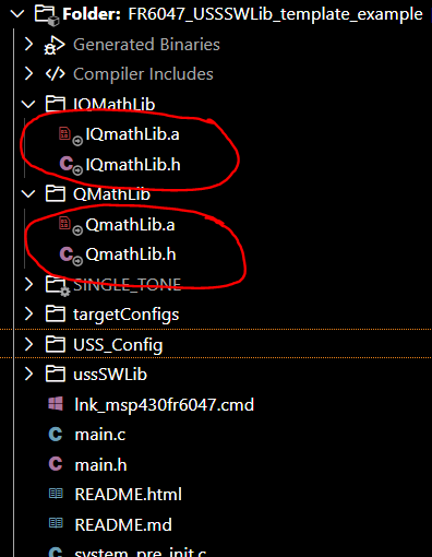

I have a question regarding CCS project sharing via GitHub. In my project on Machine A, some library files (such as IQmathLib, QmathLib, etc.) are added as linked files with absolute paths pointing to external directories, as shown in the attached image.
If I push this project to GitHub and pull it onto Machine B, will it build successfully? If not, what is the recommended best practice in Code Composer Studio to handle these linked files for Git version control across multiple machines?

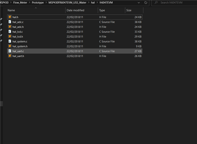

    In my case, I have physically copied all required source files into the project directory. Specifically, my hal.h file is located at: ${PROJECT_LOC}/hal/fr6047EVM/hal.h. (Picture 1)

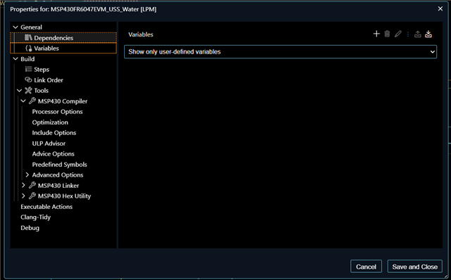

    - Cleared all obsolete absolute-path project variables (Picture 2).
    - Added the directory to the include search path: ${PROJECT_LOC}/hal/fr6047EVM (Picture 3)
    - Project Clean and Rebuild
    Then i still get Cannot open source file "hal.h". Could you please guide me to solve this problem?

  • Hello Phuong,
    At the project level, try changing the include path to the directory and not the file.
    You also have file level override, try to clean that up as well.
