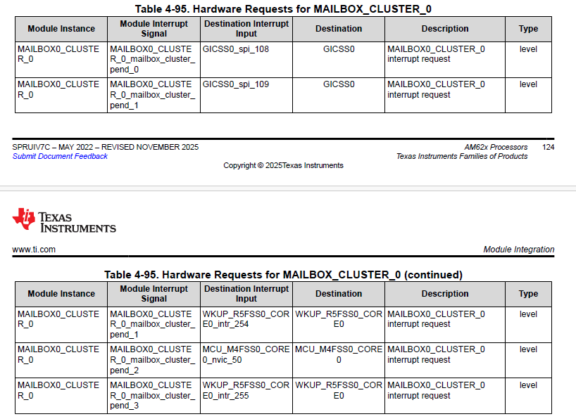

I have a question regarding the Mailbox User ID configuration when using IPC Notify / RPMessage in mcu_plus_sdk_am62x_12_00_00_27.
I observed the following behavior:
  1. IPC communication is performed from A53 Core1 to R5F using the Mailbox.
  2. R5F is halted by a debugger.
  3. GIC interrupt 109 on the A53 side is continuously triggered on A53 Core1.
During debugging, I found that one message remained in MAILBOX_CLUSTER_0_REGS0_MSG_STATUS_11, and bit 22, corresponding to FIFO 11, was set in the IRQ status register for User 1.
My understanding is that, because R5F was halted while the message was still pending, interrupts are repeatedly generated on A53 Core1 since both processors use Mailbox User ID 1.
The User IDs appear to be configured in the following file:
mcu_plus_sdk_am62x_12_00_00_27\source\drivers\ipc_notify\v0\soc\am62x\ipc_notify_v0_cfg.c
According to the TRM, it appears that R5F can also use User ID 3. Would it be possible to configure R5F to use User ID 3 instead?
If so, could you please advise:
  • Whether User ID 3 is supported when using IPC Notify / RPMessage.
  • Which source files and configuration settings need to be modified.
  • Whether my understanding is correct that A53 Core1 is fixed to User ID 1.
Thank you for your assistance.

  • Hi Takahiro,
    Yes, As you can see the mailbox interrupts are of Level type and will be active until the signal level is changed.
    You should be able to use the user Id 3 with WKUP R5F core. Please modify the ${MCU_SDK}\source\drivers\ipc_notify\v0\soc\am62x\ipc_notify_v0_cfg.c file with below code.

    #include <drivers/ipc_notify/v0/ipc_notify_v0.h>
    /* values to use when a mailbox config is not used in gIpcNotifyMailboxConfig */
    #define MAILBOX_UNUSED      0U, 0U, 0U
    /* All mailbox base addresses */
    uint32_t gIpcNotifyMailboxBaseAddr[IPC_NOTIFY_MAILBOX_MAX_INSTANCES + 1U] = {
        0x29000000U,
        0x0, /* MUST be terminated by 0x0 */
    /* Pre-defined mailbox config to allow any CPU to send and receive messages from any CPU on this SOC
     * Each element consists of [maibox base addr, hw fifo, user id]
     * These assignments need to be in sync with gIpcNotifyInterruptConfig* done later below,
     * This is a 2D array
     * - 1st indexed by source core ID
     * - then indexed by destination core ID
     * FIFO Allocations
     *   0 : M4F -> A530-0
     *   1 : A530-0 -> M4F
     *   2 : R5F -> A53
     *   3 : A530-0 -> R5F
     *   4 : M4F -> R5F
     *   5 : R5F -> M4F
     *   6 : A530-0 -> A530-1
     *   7 : A530-1 -> A530-0
     *   8 : M4F  -> A530-1
     *   9 : A530-1 -> M4F
     *   10: R5F -> A530-1
     *   11: A530-1 -> R5F
     * User ID:
     * M4F Rx: 2
     * R5F Rx: 1
     * A530-0 Rx: 0
     * A530-1 Rx: 1
    IpcNotify_MailboxConfig gIpcNotifyMailboxConfig[CSL_CORE_ID_MAX][CSL_CORE_ID_MAX] =
        /* from M4FSS */
            { /* to M4FSS */
                MAILBOX_UNUSED
            { /* to R5FSS0-0 */
                0U, 4U, 3U
            { /* to A53SS0_0 */
                0U, 0U, 0U
            { /* to A53SS0_1 */
                0U, 8U, 1U

    /* Interrupt config for M4FSS */
    #define IPC_NOFTIY_INTERRUPT_CONFIG_M4FSS_NUM   (1u)
    IpcNotify_InterruptConfig gIpcNotifyInterruptConfig_m4fss0_0[IPC_NOFTIY_INTERRUPT_CONFIG_M4FSS_NUM] = {
            .intNum = 16U + 50U,   /* interrupt line on M4FSS CPU, +16 offset to account for M4 internal interrupts */
            .eventId = 0U,   /* not used */
            .numCores = 3U,  /* number of cores that send messages which tied to this interrupt line */
            .coreIdList = { /* core ID's tied to this interrupt line */
                CSL_CORE_ID_A53SS0_0,
                CSL_CORE_ID_A53SS0_1,
                CSL_CORE_ID_R5FSS0_0,
                CSL_CORE_ID_INVALID,
                CSL_CORE_ID_INVALID
    uint32_t gIpcNotifyInterruptConfigNum_m4fss0_0 = IPC_NOFTIY_INTERRUPT_CONFIG_M4FSS_NUM;
    #define IPC_NOFTIY_INTERRUPT_CONFIG_A53SS0_0_NUM   (1u)
    IpcNotify_InterruptConfig gIpcNotifyInterruptConfig_a53ss0_0[IPC_NOFTIY_INTERRUPT_CONFIG_A53SS0_0_NUM] = {
            .intNum = 108U,   /* interrupt line on A53SS0_0 CPU */
                CSL_CORE_ID_M4FSS0_0,
                CSL_CORE_ID_INVALID
    uint32_t gIpcNotifyInterruptConfigNum_a53ss0_0 = IPC_NOFTIY_INTERRUPT_CONFIG_A53SS0_0_NUM;
    /* Interrupt config for A53SS0_1 */
    #define IPC_NOFTIY_INTERRUPT_CONFIG_A53SS0_1_NUM   (1u)
    IpcNotify_InterruptConfig gIpcNotifyInterruptConfig_a53ss0_1[IPC_NOFTIY_INTERRUPT_CONFIG_A53SS0_1_NUM] = {
            .intNum = 109U,   /* interrupt line on A53SS0_1 CPU */
                CSL_CORE_ID_INVALID
    uint32_t gIpcNotifyInterruptConfigNum_a53ss0_1 = IPC_NOFTIY_INTERRUPT_CONFIG_A53SS0_1_NUM;
    /* Interrupt config for A53SS0_0 */
    #define IPC_NOFTIY_INTERRUPT_CONFIG_R5FSS0_0_NUM   (1u)
    IpcNotify_InterruptConfig gIpcNotifyInterruptConfig_r5fss0_0[IPC_NOFTIY_INTERRUPT_CONFIG_R5FSS0_0_NUM] = {
            .intNum = 255U,   /* interrupt line on R5FSS0_0 CPU */
                CSL_CORE_ID_INVALID
    uint32_t gIpcNotifyInterruptConfigNum_r5fss0_0 = IPC_NOFTIY_INTERRUPT_CONFIG_R5FSS0_0_NUM;
