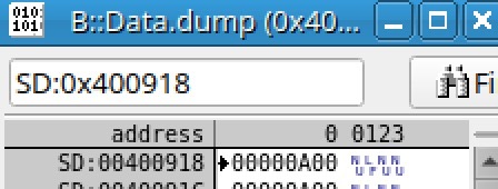

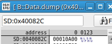

    If you have JTAG access, you should be able to connect to the MCU R5F core, and inspect the PSC registers associated with TIMER, specifically the MDSTAT and MDCTL registers. The MDSTAT register should read 0x103 or 0x3 with the 3 indicating the module is powered on.
    The MAIN domain PSC registers should be at 0x400000 + 0x800 or 0xA00 + (lpsc_id * 4).
    regards
    Suman
  • Suman,
    Thanks.  We do have JTAG access.  This is something that we can inspect.  We should be able to easily turn it on via JTAG as well to see if that allows us to gain access to the timer.
    Jason
  • Hi Jason,
    Sure.
    FYI, DMTIMER8 (and other related timers) are all controlled by LPSC_PER_Spare0 (lpsc_id value = 11 in the above formula).
    The PSC Register details are documented in the 221_PSC0 sheet of the J784S4_Registers_Public_20250808.xlsx document.
    regards
    Suman
  • Does this mean the lpsc_id is 70 if we were to start with dmtimer0?
  • If it is indeed 70, which I think it is.  Then its turned off.
    Same goes for TIMER8 - TIMER19.
  • Hi Jason,
    Yes, correct.
    Indeed, this reflects the default Power-On-Reset behavior. So, you have to turn on the modules without which any register accesses will trigger a bus error/data abort.

  • JTAG write to address 0x400918 is also denied, so we can not turn on the power through JTAG. I am able to turn on turn off the power for timer on EVM board, but not able to do the same on HS-FS board

  • Hi JIm,
    0x400918 is a MDSTAT register, which is a Read-Only Register. So, you cannot write it from JTAG (or from regular code either).
    You need to be modifying the appropriate MDCTL and PTCMD registers to trigger a transition if trying to power this up using JTAG.
    There should be no difference in sequence between GP and HS-FS devices. There is no HS-FS device on the TI EVM, so I am assuming this is your board.
    How are you turning ON and OFF the timer on EVM board? TIMER0 is powered up by SBL on TI EVM.
