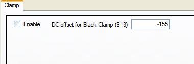

         i use the  Image Tuning Tool to tune image, when i tune the Black Clamp (DC offset)  i get a problem:
        As the UserGuide describes and my consideration, i go through the follow step :
      1. turn off AE and AWB.
       2.turn off sensor digital gain
       3.set ISIF DC offset =0 and ISIF Gain =512(1.0x) in Image Tuning Tool.
       4.disable Black Clamp in Image Tuning Tool.
       5.set black clamp DC offset  = 0( in Image Tuning Tool)
       6. disable LDC
       7.turn off Iris (no light into sensor).
       Using the Image Tuning Tool to capture a *.rawTI data, and then using the Image Tuning tool to generate the DC Offset,
       the Problem is i find i get the wrong result, the image appears i have put a wrong DC offset value .
       i am Tuning the DM368, with the Image Tuning Tool Version 2.1 and IPNC2.6.   Any input is appreciate!

    when you complete DC offset tuing in ITT, the DC offset value will be displayed in the GUI as below. What is the DC offset value that you got for your setup?. Also Could you please check the value written in Register (ISIF_CLDCOFST) is same as the value you got from the GUI.

    " when you complete DC offset tuing in ITT, the DC offset value will be displayed in the GUI as below. What is the DC offset value that you got for your setup?."  \
    The DC offset value I got from my setup is -50, and I use the command "./regrw.out 1c710b0 16 -c 1"  I read the Register ISIF_CLDCOFST value back , and it shows 0x01c710b0 : 00001fce (exactly -50) ,and i also sent value 3 to the Register ISIF_CLDCOFST  , and using the same method , i get the register value 3. and it looks all ok.
    Are there Any things I omit to do ?  Thanks for any comment!
