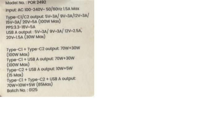

  • four LEDs which gets on when power is given to board, silkprint lable written as  LD2 LD3 LD4 LD7. in issue case LD2 LD3 LD7 goes off and ON and LD4(near to the Type C power socket ) blinks once then stable ON followed by other 3 LEDs also gets ON.
  • Hi Priyanka,
    What power supply do you use for the board? Please ensure it can provide at least 3A.
  • We use 100w adapter with type c cable , which gives 3A output
