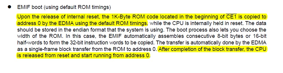

Hi Guys,
I have 6713 DSK attached with ADC which is sampling signal with maximum frequency 150 kHz then computing FFT. I burn all the codes to boot from Flash and it is working quite fine. After FFT I am writing FFT values to Flash memory.
For some reason, I am not getting the correct FFT peak from the values saved in Flash. I am sampling 10 kHz signal and the peak shows as it was 50 kHz signal. When I run the same code with CCS, it shows the peak at right sample i.e., 10 kHz.
I am wondering what is causing the change of sampling frequency while booting up from Flash ?
I will appreciate if some one comment on this issue.

  • Greetings,
    Can you share with me the Gel file you use under CCS, please.  Your issue is likely between init_emif and init_pll.
    Sam
  • Sam,
    I figured out that ADC's sampling frequency is changing when booting from Flash. For example, I set the sampling frequency to 351 kHz but when measured the ADC's clock while booting from Flash, it was showing 77 kHz. Just to make sure that it is running the same code, I checked with different sampling frequencies and realized that every time it is dividing the sampling frequency with 4 then showing the peak according to the this 'new' sampling frequency.
    I will share the GEL file soon.

  • Al Salam,
    Your Flash based runtime need to do what the following does
    OnPreFileLoaded()
        /* GEL_Reset() is used to deal with the worst case      */
        /* senario of unknown target state.  If for some reason */
        /* a reset is not desired upon target connection,       */
        /* GEL_Reset() may be removed and replaced with         */
        /* something "less brutal" like a cache initialization  */
        /* function.                                            */
        GEL_Reset();
        flush_cache();
        IER = 0;
        IFR = 0;
        init_emif();
    Good Luck,
    Sam
  • Along with the PLL init etc...
  • Walaikun As Salam,
    I am sorry but I didn't get what you mean.
    How could I debug what is causing the problem in Flash based routine ?
  • What I meant is your Flash based run time start up need to do the same sequence of initialization done in the Gel.  You have the ability to set HW breakpoints in CCS to step through the code.
  • Sam,
    How can I use HW break point to analyze the gel file ? I know I can do that with main.c but how to see Gel file sequence of initilization ?
  • I am sorry but Gel code can not be debugged, it execute in the background.  You can make a C module containing the same code, dispose then from the use of the Gel at CCS start up, load your version of start up, then you can debug the sequence of start up code.
  • Sam,
    I managed to solve the problem. I initialize the PLL and EMIF with in main() of my code. Now ADC is showing the right sampling frequency.
    I don't know why PLL and EMIF are not being initialized properly by Gel file.
    Is it ok to initilize them the way I did ?
    -Tariq
  • Yes, your stand alone run-time should do that as part of the start-up, and not depend on a Gel in CCS.
    Good Luck,
    Sam

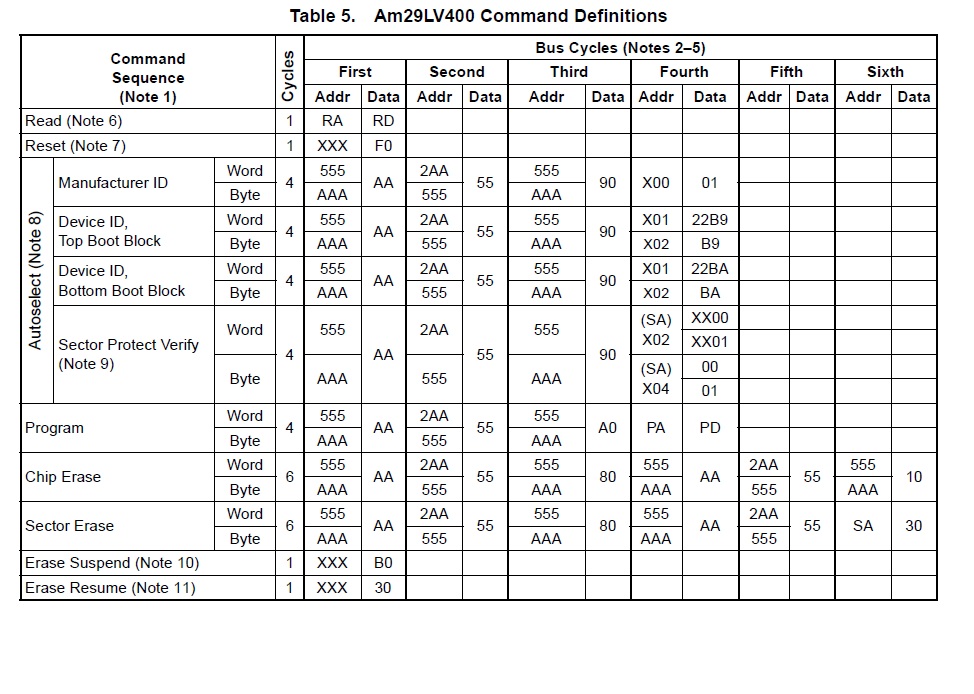

  • Al Salam,
    This line
    *((volatile Uint8 *)DSK6713_FLASH_CTL555) = 0xaa;
    appear to be for writing/programming the device in 16 bits mode on the AM29LV400.
    Can you please share with me your dsk6713_flash_write.c and its associated header files.
    Sam

  • Al Salam,
    From the FLASH DS
    It appear that the code you are using is porgramming it in WORD mode and not BYTE mode.
    Sam

  • Try this modified code set based on the FLASH device table I sent you earlier

  • Al Salam,
    1. Make certain EMIF programming is correct to access the FLASH during run-time.  At reset is has a very slow speed due to reset default values and that permit code fetch.
    2. Make certain all erase/write functions etc... of FLASH ends with the proper reset command
        /* Put back in read mode */
        *((volatile Uint8 *)DSK6713_FLASH_BASE) = 0xf0;
    3. Write a walking one (or the lower 8 bits of the address) in a test routine across the FLASH space to verify that you can write to all cells and read back.
    Good Luck,
    Sam
