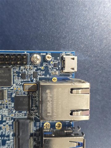

I am using TI TDA4VM SK board for my developement. I have been using this board from last 2 months and have been using ttyUSB2 to connect minicom.
Till yesterday, it was working fine. Since today morning, USB ports are not getting detected, only tty ACM is getting detected in teh list of lsblk.
Please help me to resolve this issue.
Thank you,
Neha Gupta
  • Some additional troubleshooting details that might help narrow this down:
    • The board itself is otherwise fully healthy and operational — confirmed reachable over SSH via WiFi, running normally. This issue is isolated specifically to the J4 UART-over-USB path, not a general board failure.
    • Per the SK-TDA4VM User’s Guide (SPRUJ21E), connector J4 hosts a Quad UART-over-USB Transceiver (4 ports: WKUP_UART0/MCU_UART0/UART0/UART1 → COM1-4). ttyUSB2 corresponds to UART0 (the main Linux console).
    • The onboard XDS110 debug probe (a separate connector/chip, used for JTAG) still enumerates fine as ttyACM0/ttyACM1 — so only J4’s transceiver is affected, not all USB functionality on the board.
    • Tested multiple different USB cables on J4, including one cable confirmed working correctly when connected to a different SK-TDA4VM board — same negative result on this board regardless of cable used.
    • On the host PC: ftdi_sio never loads, and no FTDI-vendor USB device (VID 0403) appears in lsusb at all, regardless of which cable or host USB port is used — the transceiver chip isn’t enumerating at the USB level, not just failing to get a driver.
    • Ruled out a host-PC software/driver change: no relevant package updates occurred around when this started, and CCS was not opened/used between the last known-working session and today.
    • The physical UART indicator LED near J4 is also no longer lighting, where it previously did.
    This points to a hardware fault isolated to the Quad UART-over-USB Transceiver chip at J4, rather than a cable, driver, or host-PC issue. Could you confirm whether this matches a known failure mode, and advise on repair/RMA options?
  • Please note : We have purchased this on 16th july 2026, this product still under warranty. So request you to let us know the process in case of raising the repair request.

    Step2: There is no discoloration, bulging, bent pins, or corrosion
    Step3: LD1 never glows even when EVM is unpowered
    Neha
    Picture of the board for your reference
  • It sounds like possibly the CP210x device is failing - possibly ESD event or other.  Unfortunately - TI does not offer EVM repair services.  We cannot offer much more help other than direction to narrow down the failure (which sounds like has been done for this issue).
