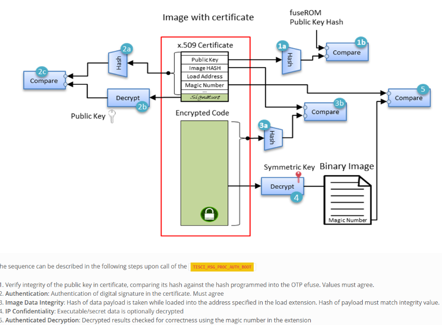

As we know, the HS-SE device will mandatory execute Secure Boot. will follow the sequence as:
If the device is HS-FS, because eFuse don't have public key hash, if we send TISCI msg of " TISCI_MSG_PROC_AUTH_BOOT" to TIFS, whethe it also handle the sequence?
We test the secure boot on FS device, tampered a byte of iamge file: xxx.appimage.hs_fs, but finally the boot sequence failed.
So we guess in FS device, even if eFuse don't have public key hash, the above secure boot sequence, still hanldled, but only the first step of "public hash verification" is skipped?
Please help to confirm, Thanks!
    This is correct. On HSFS devices, the public key hash comparison is skipped effectively meaning the authentication of the certificate is skipped and only the integrity checks are performed. This means if you corrupt even a byte then the authentication would fail. The difference from HSSE device is that an image signed with any random key would pass authentication on HSFS but fail on HSSE device. Additionally, there is no decryption possible on HSFS devices.
