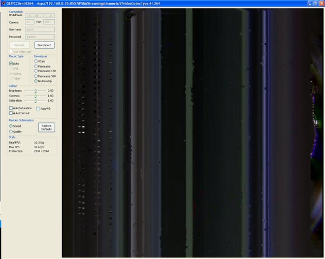

Dual stream(H264 +MJPEG) alignement trap if width more than 2048
Hi all,
   We are working on DM368IPNC for an IP camera
We are  trying to stream dual streams (H.264 + MJPEG) and we are struck with an Alignment Trap in av_server.out.
The arguments for the exe are  ./av_server.out DM368 NTSC APPRO2A AEWB GE_4MP H264 1500000 VBR AUTO MJPEG 75 MENUOFF.
The problem seems to occur when the width of H.264 stream is more than 2048.  The width is not a concern if we are configuring for H264 alone , but when configured to stream both H264 and MJPEG we are facing the problem when the H264 stream width  is more than 2048. We already upgraded to 256M memory and I don’t think we are having any memory issues for this problem.
I got the Backtrace from GDB after the crash and copying that here.
Program received signal SIGBUS, Bus error.
[Switching to Thread 762.820]
0x000ad964 in ALG_activate ()
(gdb) bt
#0  0x000ad964 in ALG_activate ()
#1  0x000ad164 in Algorithm_activate ()
#2  0x000ab138 in VISA_enter ()
#3  0x000a6c7c in IMGENC1_process ()
#4  0x000694f0 in ALG_jpgEncRun (hndl=0x4c9ac8, prm=0x4557b470, runStatus=0x4557b4b4) at alg_jpgEnc.c:174
#5  0x00061cbc in ALG_vidEncRun (hndl=0x4c9888, prm=0x4557bc8c, runStatus=0x4557bc7c) at alg_vidEnc.c:702
#6  0x00036af4 in VIDEO_encodeTskRun (streamId=1) at videoEncodeThr.c:280
#7  0x00036fec in VIDEO_encodeTskMain (pTsk=0x3db330, pMsg=0x4f52e8, curState=0) at videoEncodeThr.c:385
#8  0x000975f4 in OSA_tskThrMain (pPrm=0x3db330) at osa_tsk.c:17
#9  0x4002a8f8 in ?? ()
Cannot access memory at address 0x1
#10 0x4002a8f8 in ?? ()
The trap message on the console is
Alignment trap: av_server.out (814) PC=0x000ad964 Instr=0xe5933004 Address=0x95949497 FSR 0x001
From the backtrace it looks like the problem is with JPEGEncRun, but this dissapears if I reduce the size of H264 from 2056x2056 to 2048x2056 and I could stream out both the stream
The MJpeg dimesnions are 528x480.
Is there any restriction at the codec level we should be aware of. Would apprectiate any thoughts.
Vamsi
  • hi Vamsi,
    Can you please tell us whether you areusing latest codec for H264 and MJPEg used in V3.0 IPNC RDK.
    Those codecs support Megapixel mode more than 2048 width.
    Howver, in general can you check how you have writter the driver for 4MP mode.
    Please refer to 5MP mode driver in the IPNC RDK and check whether you are using two pass resize operation for width more then 2048.
    Resizer has restriction of width 2048 for single pass resizing.
    Raghu

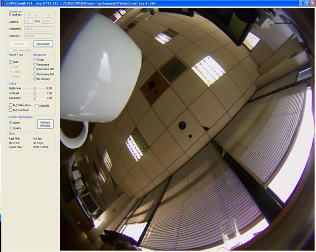

  • Hi Raghu,
       Thanks for the reply. It gave me some insights of where the problem can be.
    We ae using Version2.6 IPNC in our code.  Are you suggesting that using V3.0 might clear this problem?
    I believe we a re using two pass as I can stream the 2056x2056 rezsized output when I am configuring it for a  single stream.
    I am not sure how to check whether it is configured for the twopass or single pass method. I compared with 5MP implementation and it is quite identical.
    Could you please let me know if there is any particular variable  to check whether the camera is set to two pass or single pass.
    PS: 2056x2056 MJPEG + 640 x480 MJPEG is working fine only 2056x2056 H264 + 640x480 MJPEG is failing.
    Thanks again for the reply
    Vamsi

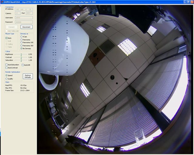

  • From the resolution it looks the width and height are not multiple of 16, can you make that and check this
    Also, can you please share the complete log?
    Raghu
  • Hi Raghu,
       I tried with 2064x2064 resolution and I am still getting the same alignment trap. Please find attached the log  I got from my console. Please let me know if you are looking for some other log and the steps to produce that. Thanks for you help .
    Vamsi

    When I increase the width of the picture beyond 2048 I can see that there is some corruption going on in the H264 encoded output.
    from 2048 < Width <=  2112 , this corruption is limited to certain region.
    for Width > 2112 , The whole picture is garabage , The scene is live as I can see my movements in the output but it looks like it has alignment problems somewhere.
    I am attaching the snapshots I took at different resolutions while streaming the H264. For all these case the MJPEG output is absolutely fine.
    Can you please give me inputs on where this might be going wrong.
