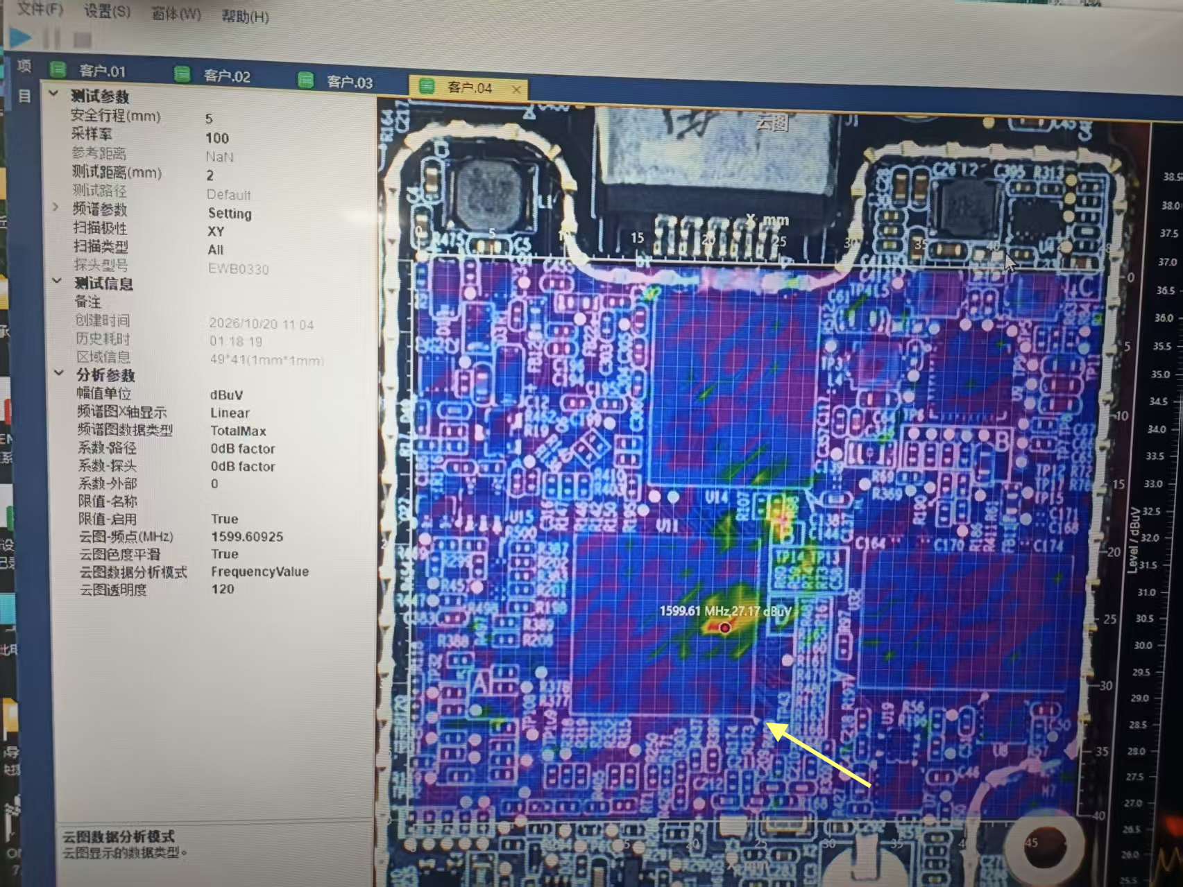

Customer scanned radiation over AM625x package, there is a frequency point 1.599GHz radiation exceeded as below picture
TThe arrow point to Pin 1, the radiation center is among DDR pin map, I guess it is DDR controller inside here.
Customer tried 750MHz DDR frequency, but the radiation frequency point doesn't change to follow DDR frequency.
Where is the 1.599MHz frequency comes from?
Suggestion to overcome the radiation? can it use SSC?

  • Can you elaborate the setup - is this a probe that customer used.
    The setup is as the picture, the probe scan the board to figure out the radiation point.
