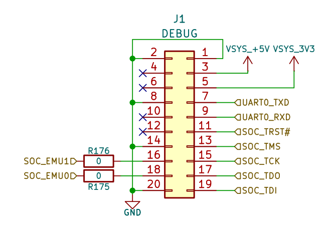

I made a custom PCB based on LP-AM243 platform. i purchased LP-XDS110 as usb debugger.
My PCB is using AM2434 and i made a pin header for connecting with LP-XDS110
I have some issue with flashing the PCB

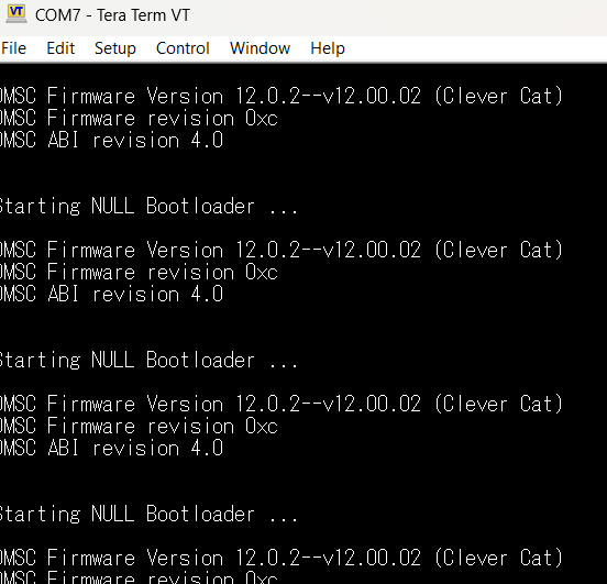

  2.  I power off the PCB and switch to OSPI boot mode, power ON again and check terminal. image.png
  4. Power off, switch to OSPI boot mode and check uart terminal. 37757e2b-91bb-4070-bcef-47b99071f28c.png
I recall that when i am used LP-AM243 and perform step 1 the output was like this
Could you help me to debug this issue?

  • Hai Aryamaan,
    Yes i use S25HL512T
    I am using QSPI boot
    i tried this python uart_uniflash.py -p COM<x> --cfg=sbl_prebuilt/am243x-lp/default_sbl_ospi.cfg
    Uart output is like this.
    I also tried to use CCStudio Uniflash to check JTAG connection
    Test connection got error
    -----[Print the board config pathname(s)]------------------------------------
    C:\Users\ekoba\AppData\Local\TEXASI~1\CCS\
        TICLOU~2\1\0\BrdDat\testBoard.dat
    -----[Print the reset-command software log-file]-----------------------------
    This utility has selected a 100/110/510 class product.
    This utility will load the adapter 'jioxds110.dll'.
    The library build date was 'Oct  2 2026'.
    The library build time was '02:46:36'.
    The library package version is '21.1.0.4116'.
    The library component version is '35.35.0.0'.
    The controller does not use a programmable FPGA.
    The controller has a version number of '5' (0x00000005).
    The controller has an insertion length of '0' (0x00000000).
    This utility will attempt to reset the controller.
    This utility has successfully reset the controller.
    -----[Print the reset-command hardware log-file]-----------------------------
    The scan-path will be reset by toggling the JTAG TRST signal.
    The controller is the XDS110 with USB interface.
    The link from controller to target is direct (without cable).
    The software is configured for XDS110 features.
    The controller cannot monitor the value on the EMU[0] pin.
    The controller cannot monitor the value on the EMU[1] pin.
    The controller cannot control the timing on output pins.
    The controller cannot control the timing on input pins.
    The scan-path link-delay has been set to exactly '0' (0x0000).
    -----[An error has occurred and this utility has aborted]--------------------
    This error is generated by TI's USCIF driver or utilities.
    The value is '-233' (0xffffff17).
    The title is 'SC_ERR_PATH_BROKEN'.
    The explanation is:
    The JTAG IR and DR scan-paths cannot circulate bits, they may be broken.
    An attempt to scan the JTAG scan-path has failed.
    The target's JTAG scan-path appears to be broken
    with a stuck-at-ones or stuck-at-zero fault.

  • This is the result:
    PS C:\ti\mcu_plus_sdk_am243x_12_00_00_27\tools\boot> python uart_uniflash.py -p COM7 --cfg=sbl_prebuilt/am243x-lp/default_sbl_null.cfg
    Parsing config file ...
    Parsing config file ... SUCCESS. Found 2 command(s) !!!
    Executing command 1 of 2 ...
    Found flash writer ... sending sbl_prebuilt/am243x-lp/sbl_uart_uniflash.release.hs_fs.tiimage
    Sent flashwriter sbl_prebuilt/am243x-lp/sbl_uart_uniflash.release.hs_fs.tiimage of size 308909 bytes in 29.0s.
    Executing command 2 of 2 ...
    Command arguments : --file=sbl_prebuilt/am243x-lp/sbl_null.release.hs_fs.tiimage --operation=flash --flash-offset=0x0
    Sent sbl_prebuilt/am243x-lp/sbl_null.release.hs_fs.tiimage of size 282165 bytes in 26.64s.
    [STATUS] SUCCESS !!!
    All commands from config file are executed !!!
    Do you get the following logs on the UART console?
    Regarding the SBL OSPI case:
    can you please try using the following example.syscfg files and let me know if see the relevant logs on the UART console?

  • Hi Aryamaan,
    The output from sbl null is really strange, like what i said at the first time. I attach in video below
  • Hi Bayu,
    Understood. Apologies, I must have missed this screenshot from earlier:
    Let me talk to the hardware team to see if it could a possible hardware issue.
    Aryamaan
  • Okay, thank you for your help. Should i attach the schematic of my custom board?
  • Yes, that would be really helpful. You can attach it over here or you can send it through the private message channel or even email it to me, since this is a public forum.
  • Hello Bayu EKO
    Please terminate the JTAG and EMU signals and Chek. Please refer pin connectivity section of the processor data sheet.
    Reference schematic
    Sreenivasa
  • Hi Sreenivasa,
    Okay noted. i will try as your recommendation.
    Is there anything you notice from my schematic? any other recommendation or notes?
  • Hello Bayu EKO
    The EMU pullup ensure the processor operates in normal mode.
    I can continue the review after you try mounting the pulls and doing a quick check.
    Sreenivasa
  • Hello Bayu EKO
    I do not see any ESD protection provision near to the connector.
    Please ensure you are operating or testing the board in an ESD controlled environment.
    Sreenivasa
