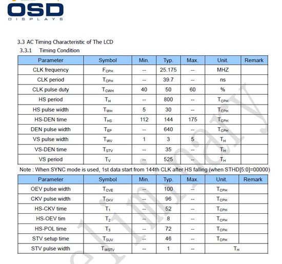

  • Thanks for your reply. Things are a bit clearer now, but still I cannot see anything on this new LCD we have. When I load the image on this board, there is this script file in the /etc/init.d folder:  load-hd-firmware.sh. If this is not executed, then the /dev/fb0 is not created.

    I know I have to change the numbers above in /sys/devices/platform/vpss/display1/timings. I put <25175,640/144/30/10,480/35/3/10,1> but it did not help (I also changed the fbset resolution to 640,480). One more point is the setting above 'rgb888'. The LCD we use (OSD057T0679-29TS) uses 6 pixels per colour (18 bits data signal). I tried something with the .../video1/trans_key_xxx, but to no avail. If somebody can help with the timing values above, here is a picture with this LCD's timings.  Thanks
