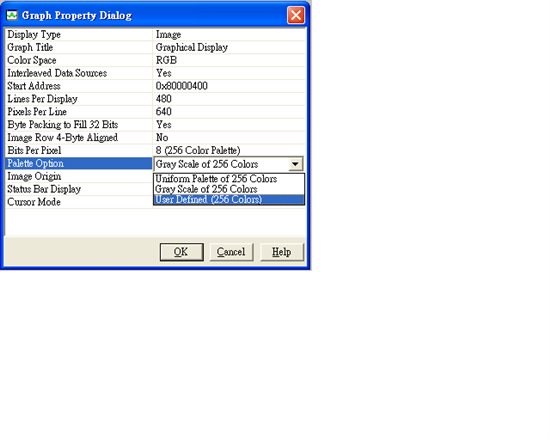

I use the view >> graph >> image by the configuration and two types palette option (gray & uniform).
The image is my desk with two computer screens ~

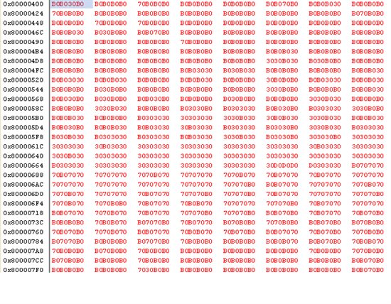

It's strange that if I cover the image sensor , it should output all black 0x00 , right ?
I've checked the CMOS sensor output pins ,it outputs 0x00 for sure !!!
But there's always value at MSB in DDR memory like this:
hope for your help .
