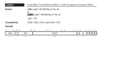

  • thnks for reply
    i have studied LDBU from Reference Guide. it has 15-bit offset.
    one of line of my code is like follow
    #pragma DATA_ALIGN (rake_test_DWork , 8)
    with align 8 bytes.
    i changed to minimum
    #pragma DATA_ALIGN (rake_test_DWork , 1)
    1 bytes instead of 8.
    problem is:  error: offset too large
                                      LDBU .D2T2*+B14(_rake_test_DWork+8),B0;   I142I
    here 1byte(8 bit)+ 8 =16 bit happen and offset is 15- bit only
    so, how to solve this problem
  • Nikhil,
    Why did you change the alignment to 1?
    Which value in the LDBU instruction line do you think is the offset value that is being reported as too large? What is that value in hexidecimal?
    RandyP
  • i refer this "ucst15" which has 15 bits
    thnks
  • Nikhil,
    That was not my question. My question was in reference to the LDBU instruction line that you referenced with the error message:
    What is the hexadecimal value of rake_test_DWork? This is what I was asking, but I wanted you to understand first what part of the instruction above was the offset part.
    What is the size of the .bss section of memory?
    What is the difference between rake_test_DWork and the start of the .bss section?
    Put this back to 8-byte alignment, if that is what your application requires. This has no relationship to the assembler error message.
    This equation has no meaning. The three different numbers are in different units. You are adding an addressing alignment value to a physical constant and equating that to the width of an addressing offset.
    If you can answer my questions above, then you may find your solution. Please post your answers to my three questions and any new thoughts you may have on a solution.
