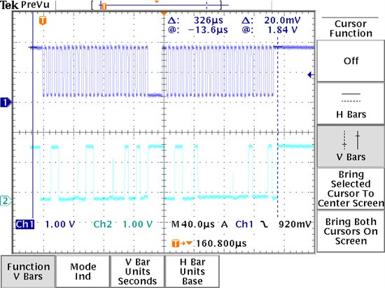

    The oscilloscope view for the successful read can be seen below. The value from Stream_write (0x00 and 0x91) is not correct according to the oscilloscope view.

  • Hi Raghavendra,
    Yes, the first loop succeeds with no errors, but with unexpexted data (compared to oscilloscope view). Yes, the write for the second loop fails.
    I will try to debug as you described.

    Actually, the write does not fail. In fact its because of the read the I2C timeout occurs(Stream_read might return, but it may not complete successfully). If you refer the AIC31 Codec Figure 18 explains i2C read. Since the codec register itself is 8 bit, its not possible to read 16 bit data. Refer the sample application shared earlier which has the implementation for performing read/write with the Codec.
    Step A: Write the address of the register to be read(Note: The I2C stop should not be issued)
    Step B: Issue I2C restart.
    Step C: Read the value of the register.
    Hope this helps..

    I am using a custom boards and the I2C slave I'm communicating with is a camera. It has 16-bits registers.That's why I read 16-bits. It is the same camera I use together with my PG1.0 based boards, so the camera is ok. You can also see on the oscilloscope that the pulse sequence is valid.
    I have not been successful stepping source code in the driver, but I have been setting breakpoints in disassembly to see what happens. The interesting thing is that if I set a breakpoint in i2cCommonIntrProc() and then continue executing the Stream_read returns the correct value (0x00, 0x10 as seen in oscilloscope view). After that the next Stream_write in the next lap of the loop is ok.
    Could there be somekind of race condition in the driver?

    /* update the threshold to the residual value so that the *
    * remaining value is transferred.in SLAVE mode it is not *
    * required as the threshold will already be 1 */
    threshold = chanHandle->currBufferLen;
    else
    /* This is a normal transfer.Hence program the threshold count*
    * of data */
    threshold = instHandle->rxThreshold;
    Let me know..
    Raghavendra
    How do I rebuild the library?
    BR;
    Jonas
  • Hi Jonas,
    Please refer section 1.3.3(Building the BIOS PSP Driver Modules - step 2) of the BIOS PSP Userguide placed in the top level docs folder of the psp package.
    Before building, please make sure you go through the following sections too - 1.2, 1.3 of the Userguide.
    Hope this helps..
    Raghavendra
  • Hi Raghavendra,
    I have rebuilt the driver and removed the rxThreshold setting from the cfg file. The cameras start up as expected, so it seems like you have the solution there.
    Jonas
