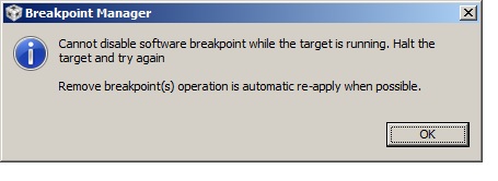

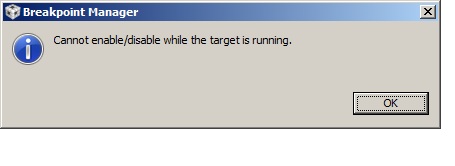

Re. the BP Q, I do get the following sometime
When does this error messages come? Is it when you try to do something (Please let me know what is that) OR during normal running after enabling "update all views"?
Bhavin
I get this random when I attempt to enable or disable a BP while CPUs are running.
CCSv5 requires you to halt to set a breakpoint. This message should not be random but should occur every time you try to set a breakpoint while running. Earlier versions of CCS would appear to set the breakpoint while running but actually halted the target, set the breakpoint and then run it again. Most users didn't realize that this is what was happening. Thus the default behavior has changed in CCSv5.
