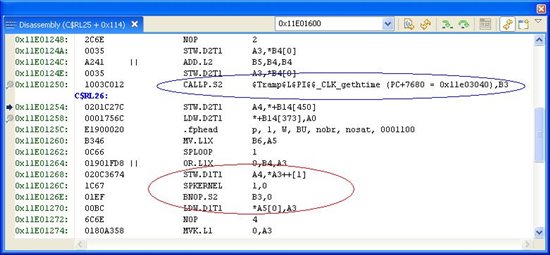

When the function is called, the code gets stuck in an infinite loop, repeatedly jumping back to the first instruction following a call to CLK_gethtime( ).  In looking at the assembly window, I can see the CALLP to the trampoline function, where the B3 register is set to the return address and the function call executes normally and returns.  A few assembly lines down, I see what seems to be the start of the If( ) statment, but then there is a BNOP.S2 B3,0 instruction, which puts me right back at the return location of the previous function call.  This happens indefinitely.  This happens for both the 6.1.20 and 7.0.5 tools.  Happens with -O1 optimization as well.
Below is the C code fragment and a picture of the dissassembly window associated with it.

Here is a snapshot of the dis-assembly window,  with the instructions in question circled in RED.
Any thoughts? Ideas?  Is this the type of code you'd expect to see?  why the BNOP.S2  B3,0 back to the original return address?

  • I think we need more context.  Notice the SPLOOP and SPKERNEL instructions, which the compiler generates for certain loops.  There is no loop in the C fragment you show.  Does this spot in the disassembly look the same just after loading the program, but before running it?

  • You should be able to set a breakpoint at _c_int00, which will be before any instructions are executed.
    That code looks very different.  What else in the project changes when you move this code?  Did you change any compiler options?   Is a lot of other code dragged along?  The second screenshot doesn't show a trampoline.
    The first screenshot you show looks very strange, and not at all like what I would expect from the compiler, so I wanted to make sure we were looking at the compiler output.  The second screenshot looks more reasonable, but it's still such a tiny window into the problem that I'm reduced to guessing.  I can't say for sure whether the code looks reasonable without seeing both the C code and assembly code for the entire loop.
    So far, this does not look like any problem I'm familiar with, so more analysis is necessary.
  • OK,  thanks for the tip on putting the break point at _c_int00.  What I am finding now is that when hitting the break point at _c_int00 and viewing the code space, the code is correct, it looks more like snapshot of my second post, no unexpected branch instructions.
    Next, if I do a "go main", and stop at Main, the code space in that area becomes corrupt and it looks like the 1st snap shot.
    Next if I do a "reload program/go main" sequence, (even without the breakpoint at _c_int00), the code is correct.
    SO... it appears an issue with my tools/debug environment and as I think about it, it probably has something to do with the cache settings that are active when the code is 1st loaded (which are probably determined by the gel file executed after the "Connect to target" operation) compared to the cache settings that are active the 2nd time the code is loaded after running to main (which at that time would match the cache settings as set by the SW as it runs from _c_int00 to main).

    Check your cache settings by reading the L1PCFG register at 0x01840020. Read it before loading your program, after loading your program when the PC is at _c_int00, and once the PC has reached main.

    Yes, it looks like I need to tweak my Gel file to set the cache register to the value that matches my intended use within my application. (looks like at power up the register is 0x0007, I need it to be 0x0003 for my particular use).   I did a test where I changed it by hand to 0x0003 after connecting to the target and then did a "load Program ->Go to Main", "run" sequence and the code is executing properly.
