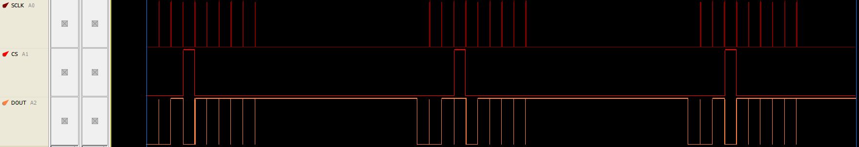

    Hi Simon,
    Did you manage to work with this GPIO configuration, I am also stuck with this EVM5515 + ADS1298 FE issue. I have tried everything to get some meaningful data. I can take data from two leads only, below are my readings. Please let me know if you get any progress.
