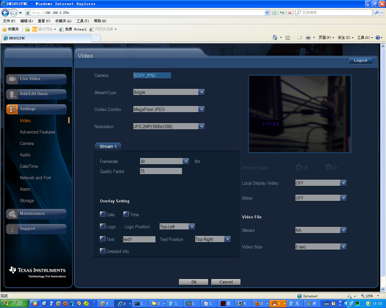

Dears,
I need play 5M mjpeg for appro ipnc368 code base, 5fps frame rate is accessable. In WISJPEGStreamSource.cpp, I modified fLastHeight and fLastWidth
            fLastHeight = (fBuffer[i+5]<<5)|(fBuffer[i+6]>>3);
            fLastWidth = (fBuffer[i+7]<<5)|(fBuffer[i+8]>>3);
            int tHeight  = (fBuffer[i+5] << 8) | (fBuffer[i+6]);
            int tWidth = (fBuffer[i+7] << 8) | (fBuffer[i+8]);
            int scale = 16;
            fLastHeight = tHeight /scale;
            fLastWidth = tWidth / scale;
But I can't find where to modify in my appro activeX play control client code. I browse the ffmpeg source code, it seems there are no mjpeg rtp decode code to recovery jpeg picture width and height.
Can help me?
