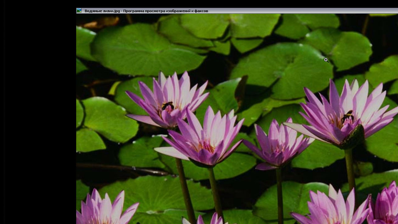

  • Hi.
    Now i can capture some image (i hope it is rgb24 image) from my pc through tvp7002 and show it on hdmi display. But the image is shifted to the right and down and has a magenta offset, i.e. the black color is magenta. I have modified tvp7002.c file to make tvp7002 output RGB and modified ti81xx_fb.c to make hdvpss receive rgb. I tried different options, but cannot make it wotk properly.
    I use saLoopBackFbDev.
    The values of the registers for tvp7002 are the same as Hardik Shak suggested here (http://e2e.ti.com/support/dsp/davinci_digital_media_processors/f/717/t/154092.aspx?PageIndex=2)
    Does anyone has ideas what else should be modified to receive 24RGB?
  • Ok. I changed the register 0x10 in tvp7002 from 0x5D to 0x58 and the colors is alright. But the image is still shifted.
    Can you please send me the image. Also send me ti81xx_fb.c file you have modified for RGB capture.
    Hardik shah
  • Hi, Hardik.
    Here is captdump from saLoopBackFbdev program. The size  is 1280*720.
    3678.captdump.zip

    It is a c file. But this site doesn't allow to upload c type file.
    Jpeg image is made from captdump for your convenience.
  • And more information. I use PSP 04.01.00.07. M3 binary file is from  HDVPSS-01.00.01.33 for 512M board.
    Alexander Vasiljev.
    I had been waiting for new ezsdk, but now i still cannot get right synchronization capturing rgb24 from tvp7002. I have tried different polarities in the ti81xx_vpss.c file, but the image is shifted with any polarities.
    Alexander Vasiljev.
