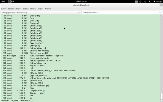

    But It can not kill ipnc_rdk_mcfw.out. Run ps command to see the process, The result as follows:
    Why can not kill ipnc_rdk_mcfw.out?

    when you run killall -2 ipnc_rdk_mcfw.out, there will signal sent to UI_signalHandler function in mcfw_ipnc_main.c
    You can prints there and further debug this issue?

  • Thank Raghu Kudva:
    UI_signalHandler function code as follows:
       //gUI_mcfw_config.demoCfg.stopDemo = TRUE;
    //gUI_mcfw_config.demoCfg.unloadDemo = TRUE;
    //gUI_mcfw_config.demoCfg.delImgTune = TRUE;
    gUI_mcfw_config.demoCfg.exitDemo = TRUE;
    It never stops ipnc_rdk_mcfw.out.
    I modify the code as follows:
    When run killall -2 ipnc_rdk_mcfw.out,It trys to stop ipnc_rdk_mcfw.out,
    but App_stopDemo()->Venc_stop()function can not return.
    So ipnc_rdk_mcfw.out is still running.
    Why?
    Thanks a lot!
